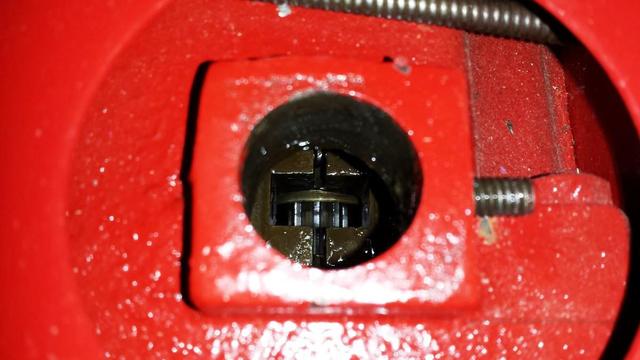

Racinbob 12,996 #4 Posted September 14, 2015 You're probably going to be fine. Worse case would be what Garry said but that would be easy to fix. Back the set screw out more to remove the shifter and check the donut out. Providing it's OK look down the shifter hole and the forks should look like this. That's in neutral. There's a hole on the front of the shifter donut. Insert the shifter and tighten the set screw making sure the dog point goes into that hole using a 1/8" allen wrench (providing somebody didn't make their own set screw from a bolt). Snug it until you feel the resistance as you shift through the gears. Then back off just a fuzz so the resistance goes away and hold it there while you tighten the lock nut (not shown in the picture) with a 7/16" wrench. 2 Share this post Link to post Share on other sites
