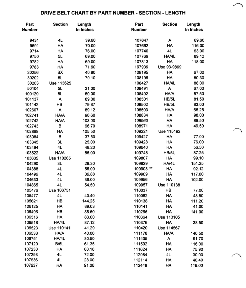

WNYPCRepair 1,924 #2 Posted September 13, 2015 Do you have a part number? I think it takes a 9750, which is 69" Chart here: http://www.wheelhorseforum.com/files/file/209-chart-belts-blades-lubrication-82-pages-492-0392pdf/ Share this post Link to post Share on other sites
Wishin4a416 2,609 #3 Posted September 13, 2015 No I don't have a number. No manual. Thanks. Share this post Link to post Share on other sites
WNYPCRepair 1,924 #4 Posted September 13, 2015 Maybe someone can confirm my part number, then you can just look it up in the chart. You should be able to find a manual here, but it doesn't show the belt part number. I found a post on another forum that said it is the 9750, and 69" "9750 is correct for the 79360 snowthrower." Share this post Link to post Share on other sites
