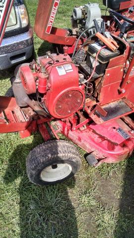

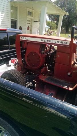

slammer302 2,157 #1 Posted September 11, 2015 I got this today has not run in years and needs a gastank but it has a nice 42RD deck and a 12hp kohler. I wasn't even looking for a new project this one came to me 11 Share this post Link to post Share on other sites

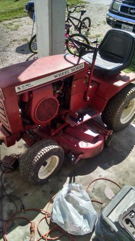

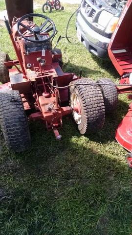

slammer302 2,157 #13 Posted September 12, 2015 Well i've been hard at it today working on the C121 first thing i did was make sure it ran good sense the gastank was no good i hooked up the gas line from the B-60 to it and jumper cables from the truck I know this looks kinda bad but it worked and the the C-121 started up and ran great i had to oil a few things up sense it had been sitting for so long. I took a chance when buying this not knowing if anything was good but so far im happy! I got the gastank switched out and new gas line put on too and got to ride it around the yard its a pretty sweet ride and the deck is nice and quite but needs a new pto belt the one on it is way to wide and rubs everywhere. Just need to change the oils and give it a better cleaning 6 Share this post Link to post Share on other sites

slammer302 2,157 #15 Posted September 13, 2015 Yeap this one was left to die because of a bad gastank and a bad spark plug one days work and it is ready for anything 4 Share this post Link to post Share on other sites

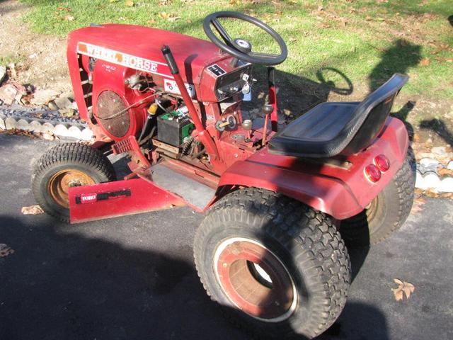

Retired Wrencher 6,966 #22 Posted September 13, 2015 (edited) the only I did not like was the cradle system on the later c`s. I had a c141 that had this I found the cradle rob a lot of power, rather than a bolt in Kohler. Sorry an old P/Bucket pic Click on it to enlarge. Edited September 13, 2015 by T1257 Share this post Link to post Share on other sites

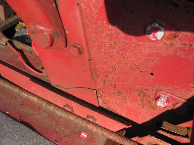

AMC RULES 37,259 #23 Posted September 13, 2015 Them C's have their issues too... Share this post Link to post Share on other sites
Racinbob 13,123 #24 Posted September 13, 2015 (edited) I forgot about that Craig. This is my 76 that I bought new, sold in 2000 when we moved here and stumbled on to it again a short time ago. This was taken at the current owners place. You can see the patch in that spot. I don't remember when I did that but at least it held up well. I attributed the problem partially to never using the assist spring with the tiller or snow blower. Edited September 13, 2015 by Racinbob 2 Share this post Link to post Share on other sites
squonk 48,038 #25 Posted September 13, 2015 (edited) I don't know what exact model Craig pictured but on the hydro lift models, raising the lift all the way up the mower bar hits the steering support. Then either the support breaks or the whole machine will twist. My C-160 Auto does this. If I raise the lift with the hood open it won't shut right. Lot's of power in hydraulics Edited September 13, 2015 by squonk 1 Share this post Link to post Share on other sites
