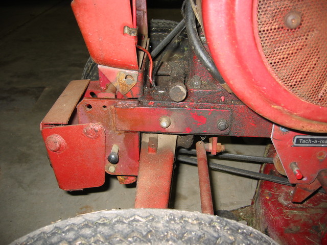

pfrederi 20,273 #2 Posted September 11, 2015 (edited) You can put tachmatic hookup on them. Then you can use new implements. I have Charger 12 and Electro 12 both modified to the newer tach matic. One is on snow plow duty the other will be on blower duty (with a replacement 16hp engine)They are great machines just make sure the hydro is still strong. Get her fully warmed up then put her against and imovable object she should spin her wheels on pavement or dig a hole on dirt.My charger with tachmatic adaptor Edited September 11, 2015 by pfrederi 3 Share this post Link to post Share on other sites
