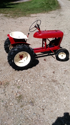

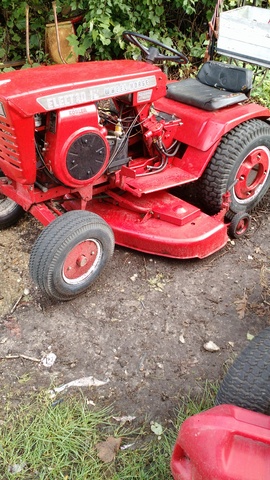

Brian01 481 #2 Posted September 11, 2015 Go to Restorations part of forum...there are paint recommendations there..For red i use International Harvester RedFor "white" I use Ruatolium or PlastiKote "Antique White" To give an idea what the colors looks like, here's an Electro 12, I recently refreshed then resold and also an RJ I am currently working on.. Share this post Link to post Share on other sites

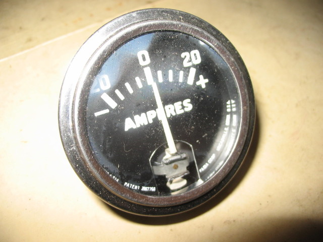

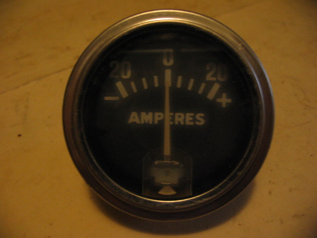

wera512 9 #19 Posted September 23, 2015 Finally got back to work on this thing.The three prong on voltage regulator has been replaced and it is charging like it should.I need to replace ammeter because on connector keeps moving around.I think that it is loose internally.Replaced the wire connector but still have to wiggle the wire to start.I am hoping any ammeter will work?Has anyone here have to replace theirs?Tom Share this post Link to post Share on other sites
bmsgaffer 2,071 #20 Posted September 24, 2015 Any 20 amp capable ammeter will work, but i dont know how easy it is to find one to fit in the hole.Place a wanted ad here, you may get lucky.You can also bypass it by just connecting those wires together and protecting them from touching anything else if you dont care about the ammeter. Share this post Link to post Share on other sites
daveoman1966 3,884 #21 Posted September 24, 2015 I have TWO 20 (+ - ) amp meter and each is from a C-120. I will put either one of them n your USA mailbox for $22.... via PaypalMy direct email is here:daveoman@windstream.net Share this post Link to post Share on other sites
wera512 9 #22 Posted September 24, 2015 A friend came over today and gave me an ammeter.This project keeps getting easier.Thanks for the offer DAVEOMAN.Tom 1 Share this post Link to post Share on other sites
