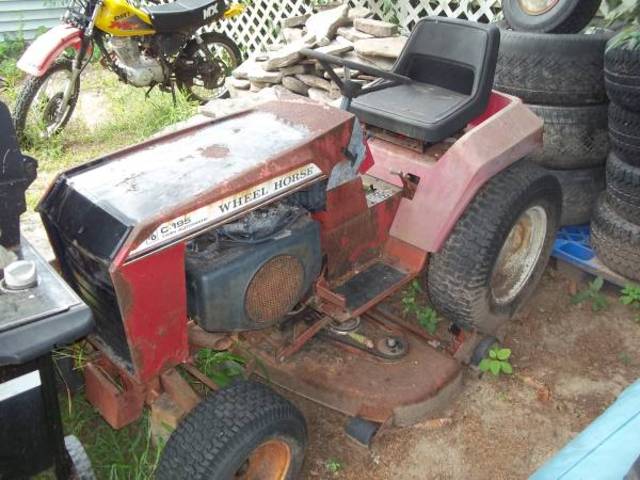

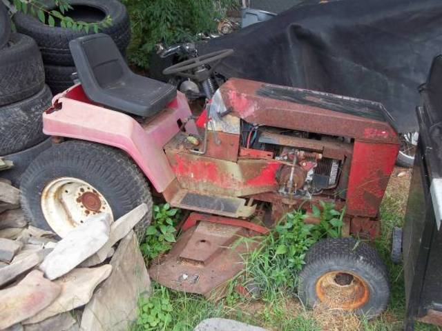

jdecker94 2 #6 Posted September 11, 2015 well i bought the tractor. doesnt run but has great compression and it feels tight. no 3 point, just a 2 foot long trailer hitch on the back. the back tires and rims are in great shape, the fronts hold air for about 30 seconds. overall its a nice machine, i cant wait to mow with it this weekend. all i need is a belt from the pto to the deck, the hour meter reads 360 some hours. hopefully its a working meter. 1 Share this post Link to post Share on other sites

jdecker94 2 #8 Posted September 11, 2015 heres the ones from craigslist. too dark and rainy to get some. 1 Share this post Link to post Share on other sites
JackC 619 #9 Posted September 11, 2015 A diamond in the rough. Looks like that coveted Super C found a good home. A little make up and lipstick and the horse will be ready to ride. 1 Share this post Link to post Share on other sites

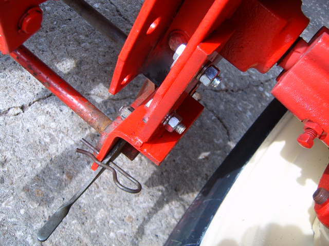

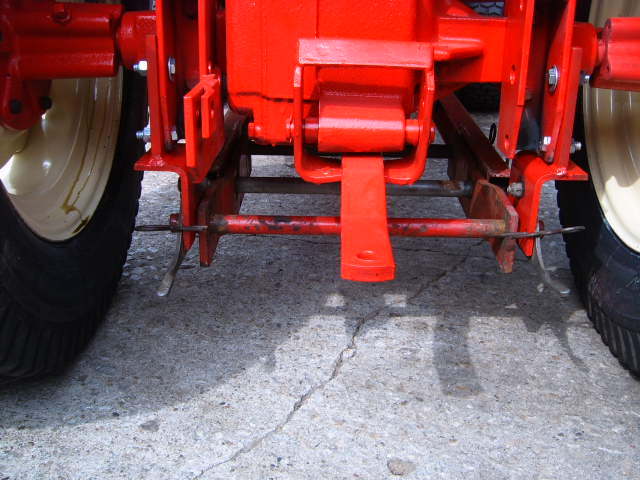

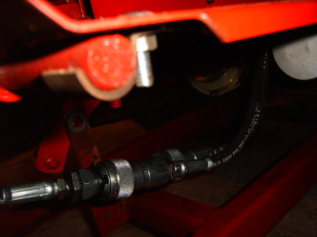

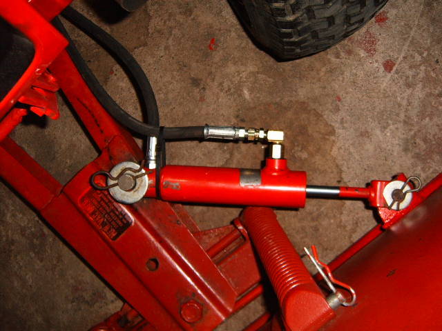

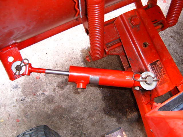

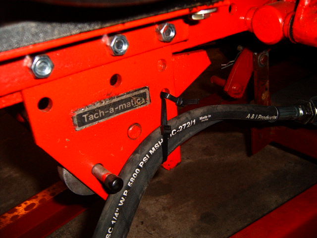

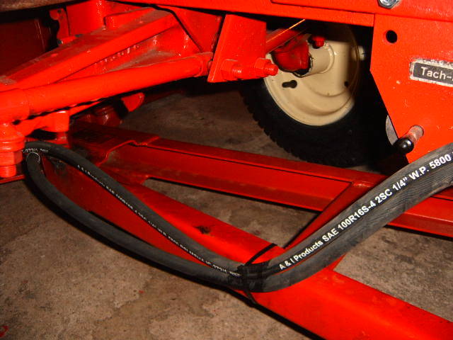

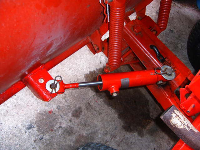

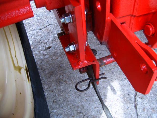

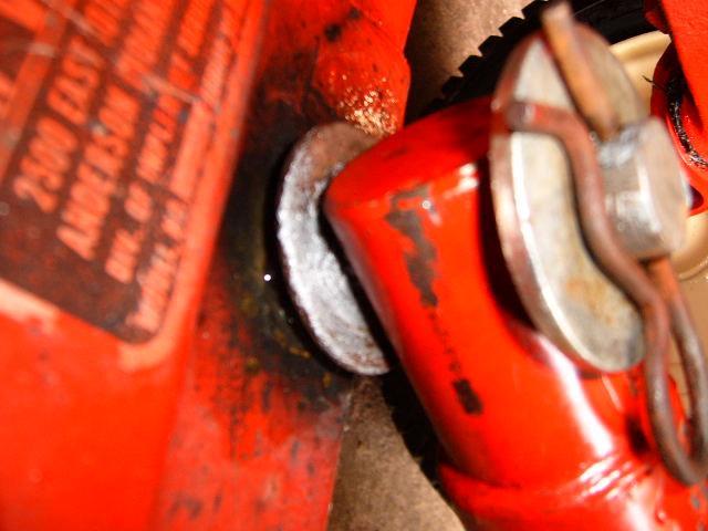

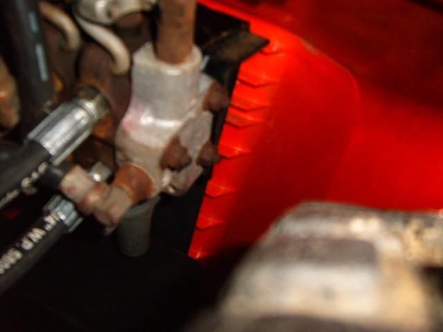

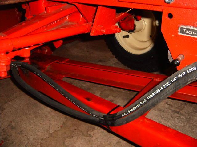

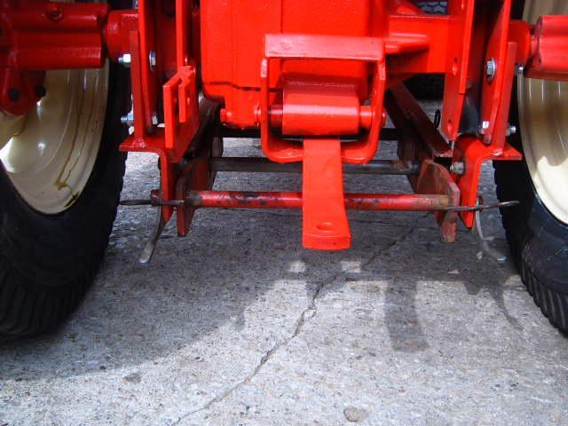

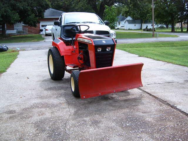

elliot ness 1,916 #10 Posted September 12, 2015 Great find, W/H did not make very many of these gems. I have one an I put a C-series dozer blade on it just by using that 520 series blade extension and modifying the rear blade mounting bracket, I will post a few pics. Oh and I also made it a hydraulic side to side blade. 4 1 Share this post Link to post Share on other sites
