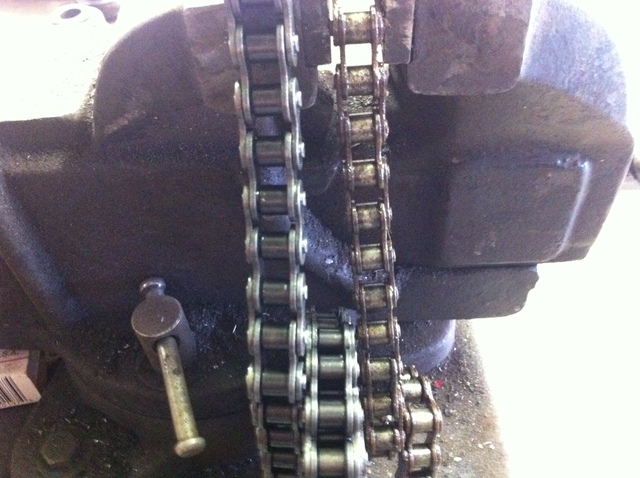

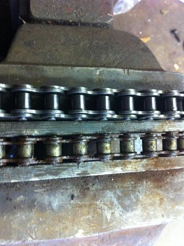

squonk 44,980 #3 Posted September 10, 2015 Thanks for the chart. I looked for something like that and all I found were charts Nasa would have been proud of. I think the #40 chain I have will work. Here's pics of the old and new side by side. Share this post Link to post Share on other sites
cheesegrader 434 #4 Posted September 10, 2015 Looks like it will work. I think your new chain is just a little heavier.The next size up or down at Fleet Farm is nowhere near what you have. Share this post Link to post Share on other sites

rjg854 12,695 #6 Posted February 2, 2021 Mike I'm almost positive that when you did that same blower for me, it was a #40 chain. Share this post Link to post Share on other sites
squonk 44,980 #7 Posted February 3, 2021 1 hour ago, adsm08 said: @squonk How'd that chain work out? I'm in the same situation now trying to get an ST-326 chain replaced before the next snow hits in five days. Been on there for 5 years. 1 Share this post Link to post Share on other sites
adsm08 3,932 #8 Posted February 3, 2021 Just now, squonk said: Been on there for 5 years. Cool. That might be something I can actually source and install before the next storm. Share this post Link to post Share on other sites
peter lena 9,606 #9 Posted February 3, 2021 SQUONK, agree with above on the # 40 chain , another thing with that is to stay with a chain specific lubricant , yours looks good . most of the time they are starved for lubricant , also pay attention to your tension , should be able to spin it over by hand , never let it dry out, pete Share this post Link to post Share on other sites
