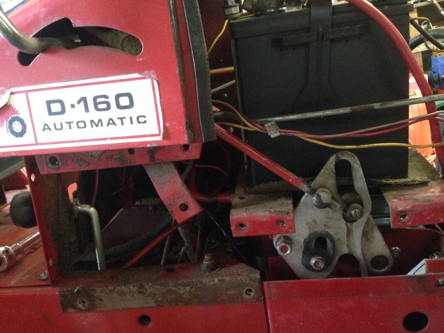

dewdew 10 #1 Posted September 8, 2015 I rebuilt the hydro pump for my d160.i got it all together but my reverse is very slow at first bet after I run it for about 1/2 hr I lose it completely. My motion control lever does not go all the way back but it looks like everything is adjusted correctly. I hope.is it possible that I did something internally to the pump that would cause this ?FYI; there is a leak round the shaft that needs attention but the fluid is never low enough to not register on the dipstick. Share this post Link to post Share on other sites

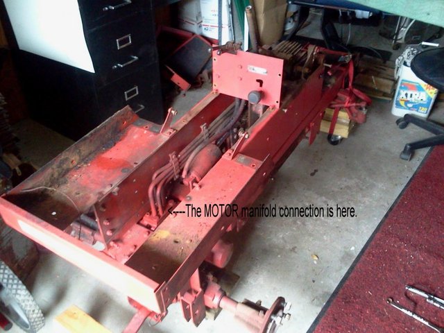

daveoman1966 3,884 #7 Posted September 9, 2015 (edited) Having successfully rebuilt 20 or 25 of these Sundstrand units, it is an impossible guess as to what could be wrong....especially not knowing exactly what you did (or did not do) in performing the rebuild. Inasmuch as the oil is common to the hyd pump and the hyd motor and that their internals also have nearly identical parts, to rebuild just the pump is futile...both must be rebuilt. The hyd motor is bolted to the side of the gearbox, supplied by oil thru the 4-line manifold. As for the linkage adjustment....without having it in-hand, again impossible to resolve. You need to find some schematics of the linkage to be sure you put it back together correctly. The D-160 was made from 1974 thru 1980 and there are linkage variations. Go here and select PARTS tab. Then, enter D-160 and clik the next page...then select your model #. Some schematics are available....some are not.http://www.toro.com/en-us/parts/Pages/PartsLookupResults.aspx?searchTerm=d-160&BasicSearchFilter=equipment Edited September 9, 2015 by daveoman1966 3 Share this post Link to post Share on other sites
