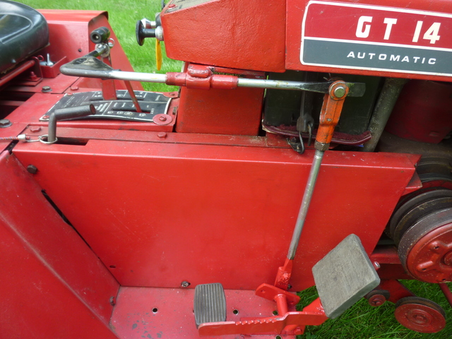

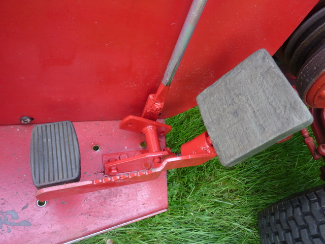

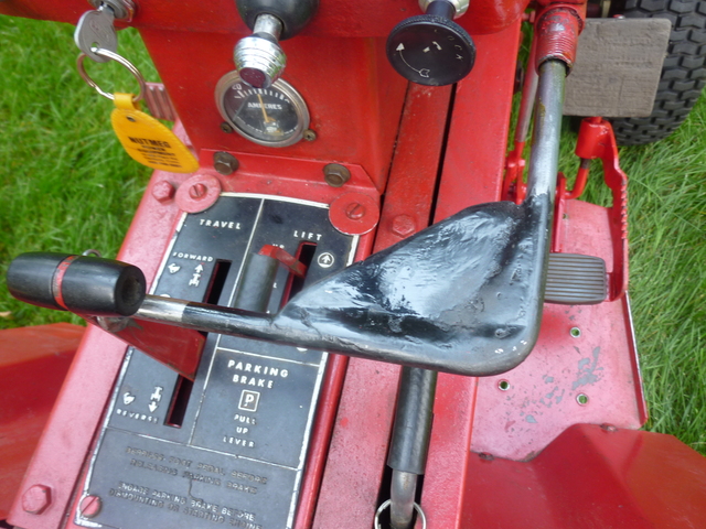

Rob R 989 #1 Posted September 8, 2015 Always wanted a Pedal since when I am snow plowing I need an extra hand.... now I can use my foot. I went from the top since it would have been next to impossible down the middle of the tractor since I have the "rock shaft" for the rear 3 PT hitch. Works like a charm and I used metal and misc. parts I had in my "Hoard Pile". The top pedal is from a plow skid and the reverse pedal is from an old Dynamark tractor... for the operational lever I used a Sears Suburban Mule Drive engagement swivel and lever. Both Pedals can be adjusted up and down since the slid and lock via a pinch collar and nut on the back. It is very heavy duty and should stand the test of time. P.S. you can still use the Tee Handle if you so desire 3 Share this post Link to post Share on other sites
