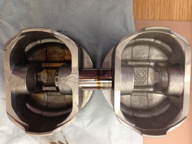

Horse46 519 #60 Posted October 19, 2015 I guess I have proven I'm out of my depth here. My piston turned up yesterday and on the box it had written 16 010 I open it up and on the piston is .25Well I thought Bo**** 10 days wait and I get the wrong piston!So I contact the seller and he points out that .25 is 010, well what the hell?If I had engaged my brain for a second I may have noted that.In my defence though, I didn't expect a piston for an American motor, from the States to be in metric.that's my excuse anyway and I'm sticking to it. 1 Share this post Link to post Share on other sites
Horse46 519 #61 Posted October 20, 2015 (edited) Looking at the pistons side by side, I'm of the thinking that someone has had this motor open before and tried to botch it together and hope no one notices until it goes bang, from the leaking sump to the governor gear hanging just above the cam shaft, and the tail off the con rod cap Edited October 20, 2015 by Horse46 Share this post Link to post Share on other sites
Horse46 519 #62 Posted October 27, 2015 Well every day IS a learning day.I spoke to an old friend of mine today, who I forgot was an engineer. I asked him a few questions about my engine, and without seeing it he gave me an in-depth report of the internals of my enigine including any known issues of reliability.I said about my concerns of fitting the new rings and how to put the wrist pin in, because of my old piston cracking. He concluded that the old wrist pin had seized and it was my tapping that probably caused the crack, because the pin should fall in and out under normal conditions. He then proceeded to show me with the new one, and fit my piston rings for me. I also got a load more info on my reassembly woes, well not anymore.I think he would have fixed it for me too if he wasn't off on his annual migration to NZ, although he did offer to help if it was still in bits come April. I'm hoping to have a crack (no pun intended) this weekend if the weather is ok. 2 Share this post Link to post Share on other sites

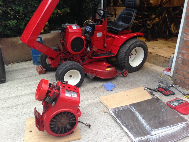

Horse46 519 #65 Posted October 31, 2015 I got the motor almost back together today, I have to say though that some of the torque settings seem ridiculously high. My main concern now is getting the governor arm fitted correctly, I've read the book but it seems difficult, but I was tiered when I read it. Share this post Link to post Share on other sites
Horse46 519 #66 Posted November 1, 2015 My back is in bits!I had to roll the last engine move on my sons skate board, I just didn't have another lift in me.Still a bit to do, but I ran out of daylight so thats me probably till the weekend. 1 Share this post Link to post Share on other sites
Horse46 519 #67 Posted November 8, 2015 Hey there, I'm after some advice on starting the motor after a rebuild. Is there something I should do or just stick oil in and hit the go button?I have the governor arm to set up, and a check of all the nuts n bolts to make sure I haven't overlooked anything. 1 Share this post Link to post Share on other sites
Shynon 7,596 #68 Posted November 8, 2015 As long as you lubed everything up during assembly fill it up with oil and fire it up. Do not let it idle. I run my for 1hr at full throttle (3600 rpm) then drain oil and put fresh in. Then I use it and after 5 hrs change oil again and you should be good to go. Do not let it idle during the first 5-6 hrs. Full throttle. 1 Share this post Link to post Share on other sites
Horse46 519 #69 Posted November 8, 2015 I've only ever had one completely new engine and that was on a bike, and run is procedure was not to over rev or let it idle. Full throttle for an hour seems excessive . Share this post Link to post Share on other sites
Shynon 7,596 #70 Posted November 8, 2015 Prondzy and I have built a dozen kohler's using this method. We actually like to pull a plow for 5hrs + after initial 1 hour run to build heat and help seat valves and get rings to wear in. You need heat with good lubrication to get motor to break in. Short runs will not help. I do not start up a new motor just to move a tractor until 5hrs of run are complete, I push it. You are correct not to over rev or idle. Share this post Link to post Share on other sites
Horse46 519 #71 Posted November 8, 2015 My garden doesn't have 5 hrs of work in it, I could drive it around with the deck running for a couple of hrs if the weather plays along. Does it need to be under load of could I just let it run at various speeds for an hour just to get it hot. Should I re torque the head after the 1st hr, I've taken it to 22ft lbs so far? 1 Share this post Link to post Share on other sites
Shynon 7,596 #72 Posted November 8, 2015 1st hour full throttle no load. Yes cool down and re torque the head. Share this post Link to post Share on other sites
Horse46 519 #73 Posted November 8, 2015 Thanks Shynon, it'll have to wait till next weekend so I'll have the time to give it my full attention. Share this post Link to post Share on other sites
