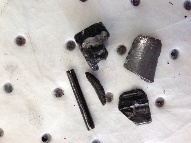

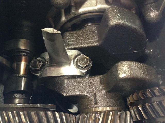

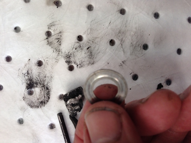

Horse46 519 #1 Posted September 5, 2015 My C-101 motor swap n refresh had a bit of a set back yesterday. I had to renew the sump gasket on the K341 as it was leaking oil, but I didn't expect to find this as the engine was running fine.Obviously one part of it is the con rod, but the rest I don't know. There doesn't appear to be any other damage, but I think a rebuild is the only answer.Has any one used the rebuild kits from that auction site, seller bat4kids? Seems reasonably priced and he ships to the UK. Share this post Link to post Share on other sites
slammer302 2,157 #2 Posted September 5, 2015 It might be hard to see but i would check the governor gear the little weights on it has a small roll pin in them that might be were that came from as long as the oil was full it probably would of lasted a while since their still is sum dipper left on the rod. I have used the kits off of ebay on 16hp kohler it has worked fine for a summer but only time will tell Share this post Link to post Share on other sites
Horse46 519 #3 Posted September 5, 2015 The PO did say when he bought it that the PO had done something to the governor. I wonder if that fell down and then the con rod fin hit it?As I said it was running fine, apart from not re starting when warm. Another question, the gears that have the half gears either side are they supposed to move side to side? Share this post Link to post Share on other sites
squonk 48,138 #4 Posted September 5, 2015 Those dippers break all the time from metal fatigue. pull out those balance gears and trow them away.do a complete tear down and inspect everything. Share this post Link to post Share on other sites
Horse46 519 #5 Posted September 5, 2015 Those dippers break all the time from metal fatigue. pull out those balance gears and trow them away.do a complete tear down and inspect everything. Are those the half gears? Throw them away?I do intend to strip as much as I can, I don't really want to but I see no other option.There is a machine shop at my work place (training school for the RAF) so I could probably get it honed or bored, but do I need to if it was ok before, as no rattles no smoke? Share this post Link to post Share on other sites

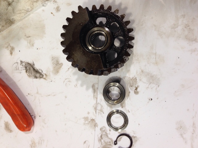

Horse46 519 #14 Posted September 6, 2015 Could this be a shim from the balance gears? Share this post Link to post Share on other sites

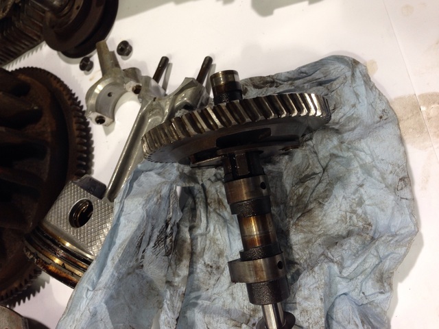

Horse46 519 #15 Posted September 7, 2015 Looking at a governor kit I think the bits are from the governor the washer too.As far as I can see apart from the con rod, and the bits I think are from the governor there is no other damage, I'm inclined to just replace those bit, junk the balance gears and sew it back up. It was running fine before hand no knocks no smoke.How much of the engine do I need to strip to get to the governor? Share this post Link to post Share on other sites
prondzy 3,890 #16 Posted September 7, 2015 To get to the govenor you need to pull all tins off, oil pan, pull crankshaft and bearing plate and pull the camshaft to access the governor. You might be able to see it with oil pan removed for visual confirmation only. Share this post Link to post Share on other sites

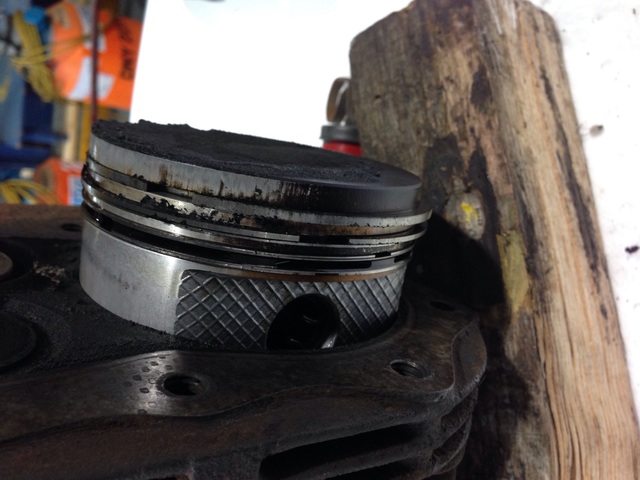

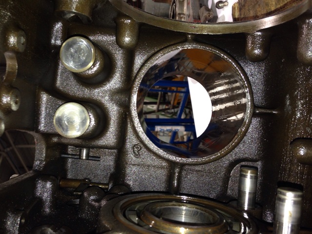

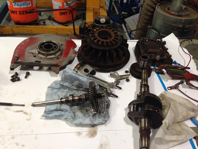

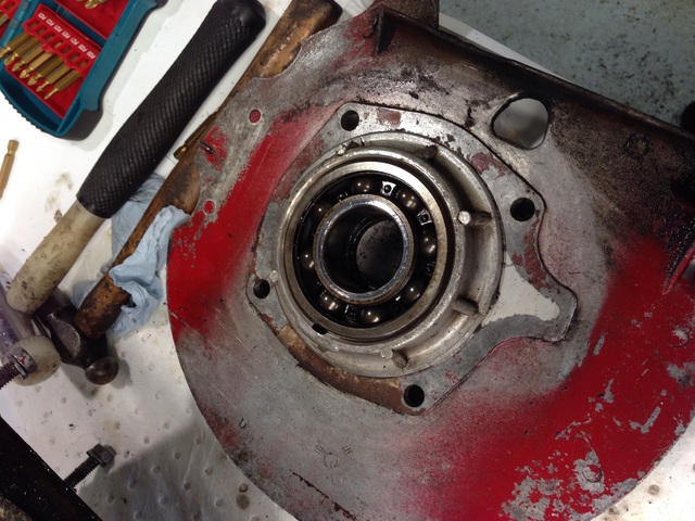

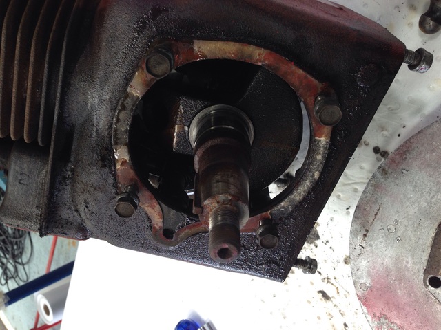

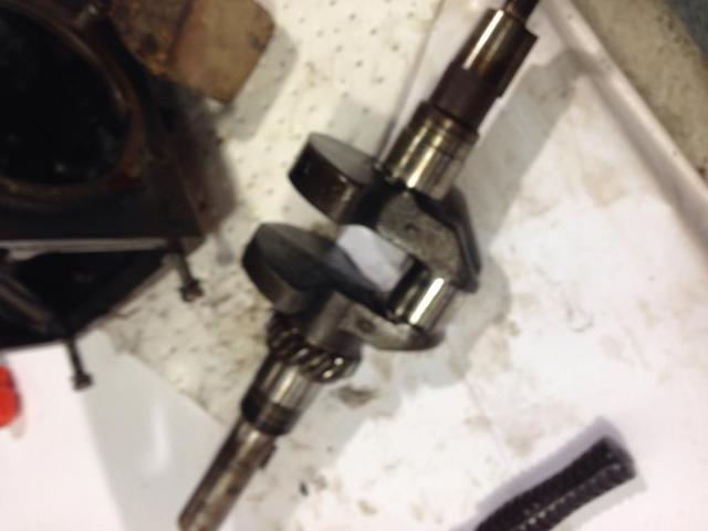

Horse46 519 #25 Posted September 11, 2015 Right or wrong I took the plunge today, I'm down to the case bar the valves and a bearing!I was hoping I could just disconnect the con rod cap and push the piston out of the way and swing the crankshaft out, but nooo. I even tried just sticking the top out, but noooo. I just couldn't get enough clearance, it has to come out.I have a bit of de coking to do, looks to have been running a bit rich looking at the valves.I have cleaned as I've gone along, bit of a clean freak, but I bet it will pay dividends come reasembly.With the balance gears removed there is going to be a big empty space left behind.I've taken a few pictures as I went along, some for you guys and some so I know how it all goes back together.I just have to clean and re oil all my parts and wait for my new bit to arrive. 2 Share this post Link to post Share on other sites
