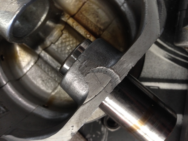

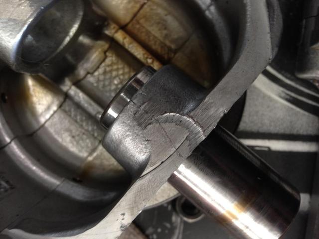

Horse46 519 #47 Posted October 5, 2015 Ah crap! Another set back. When I was removing the wrist pin I dicovered the piston had a crack. I don't know if I caused it, but I really only very gently tapped the pin out with a socket and a very light plastic hammer, there wasn't a lot of resistance but I checked every couple of taps to see how far it had moved.I've since been told it may have been caused by the temperature in the building and the two metal types? Not sure if I'm going to continue with this engine build now as it's getting expensive. Share this post Link to post Share on other sites
Fordiesel69 271 #48 Posted October 6, 2015 If you had a K301, I would say abort. But a K341 is certainly worth a piston and rings. No doubt about it. That is impact damage. Nothing you did. 2 Share this post Link to post Share on other sites
WNYPCRepair 1,924 #49 Posted October 6, 2015 (edited) New rod bolts torque to 22 Ft Lb, used at 17 Ft Lb Question for the mechanics. Why would the old bolts be torqued less? I assume to avoid stripping or snapping them, but if so, would they hold as well as new bolts torqued to 22 ft/lbs? Or are new ones torqued more because the new threads will loosen as they age/wear? I'm far from an expert, but I agree it appears to have impact damage on the bottom of the piston. Are the rest of the parts returnable? If not, then you are out that much, might be better to finish the rebuild, rather than lode that money. Plus you have to factor in the cost of a new or used engine, which if used, may or may not be a lot better than what you have now. Edited October 6, 2015 by WNYPCRepair Share this post Link to post Share on other sites
Horse46 519 #50 Posted October 6, 2015 @WNYPCRepair, The torque settings are different because the old bolts will have been stretched.I had to get all my parts from America and the postal and import charges to the UK are almost as much as the part purchase price, so returning isn't really an option.A piston is going to cost over £50 with the postage. If I take what the tractor cost, which I bought because I wanted the engine, and then add what I have payed out so far, it's getting to the point where I wonder if it is worth going forward. I still have my original 10hp motor which I have re fitted to my refreshed WH.And to add to my dilemma I have lost the use of the work shop at work, which had the back up of the mechanics on hand, and some of the specialist tools.What to do 2 Share this post Link to post Share on other sites
