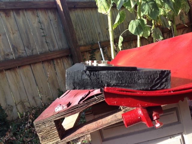

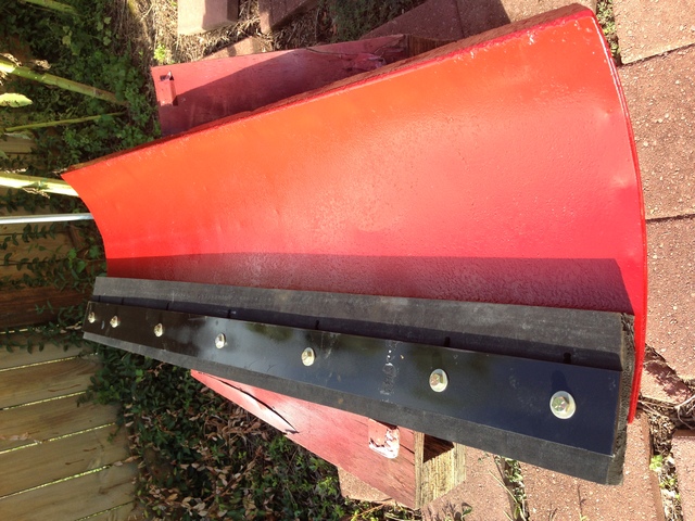

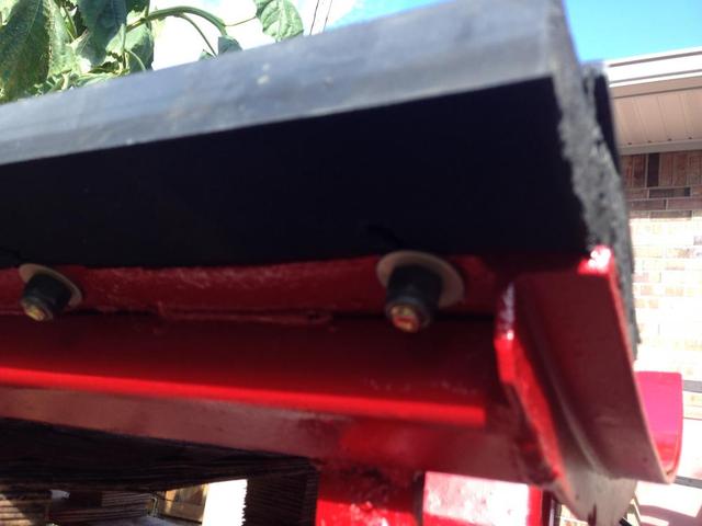

Lane Ranger 12,094 #8 Posted September 10, 2015 Ok folks this is what we are going to be using (at least my brother David will be using it) for a wearbar on the 54 inch snowplow I bought from a member in Bel Air, Maryland. I took the suggestion to find a company that fabricated snowpushers. I called and spoke to the company and they said they thought they could help make what I needed using rubber composite like they use on parking lot snow pushers. I took the old 54 inch wearbar to use as a pattern for the holes. They cut slots in the rubber (which is 1 inch thick by the way) and made a meatal cover plate with 3/8th inch holes drilled to hold the rubber wearbar on the front of the 54 inch Wheel Horse snowplow. The wearbar is 6 inches high -about twice what I think I needed but it can be turned over and slid up and down if it wears very much. The snowpusher company folks told me this wearbar will last a very long time. We will see but I was impressed that they did all this in two days. I paid $111.95 for this but I always wanted to see if this composite material might work on one of these snowplows for a wearbar. I guess we will get to find out this winter. I will keep Red Square posted. 5 Share this post Link to post Share on other sites
