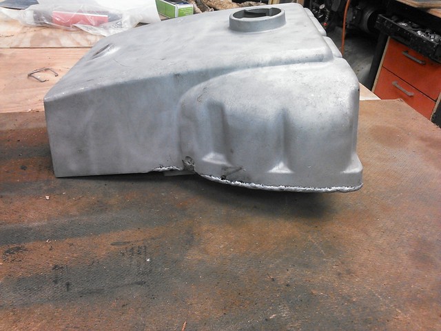

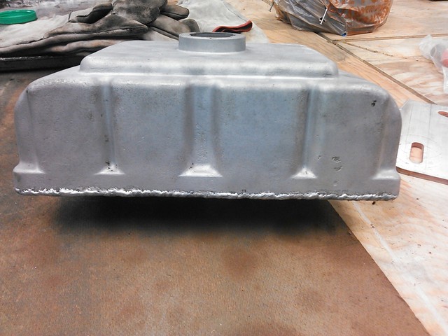

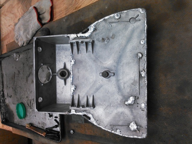

JPWH 6,338 #12 Posted September 4, 2015 Well I decided to take the hit. I have a little weld to clean up but I am pleased with the outcome. First they bead blasted both parts then cut around the 1/4-20 bolt clips. He then cut the bottom plate back to allow room for the weld to the tank. After all the cutting both parts were çleaned. He welded the weak spots in the plate then welded the plate to the tank. Tank was tested at 30 PSI and no leaks. 2 2 Share this post Link to post Share on other sites
