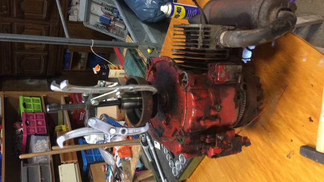

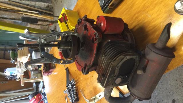

Gummix 0 #1 Posted September 2, 2015 Hello, we have an old B111 with a defective motor (piston jamming). Now I try to get the belt pulley, but this sticks. Before I try it with even more strength try I wanted to ask if its works on this away generally. It screws that inside was I removed (where the proof puller sits in) I hope u can give me a Tipp Thanks Share this post Link to post Share on other sites
daveoman1966 3,884 #2 Posted September 2, 2015 You took the bolt out...right?ps...I you break that PTO assy, I have all the parts for it here.my direct email is:daveoman@windstream.net Share this post Link to post Share on other sites
Gummix 0 #3 Posted September 2, 2015 Hi, yes i tool the bolt out.I try to heat it up, may it works on this way.Thank u Share this post Link to post Share on other sites

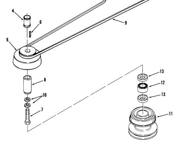

Gummix 0 #4 Posted September 3, 2015 Has someone an exploded View from all Parts of the B111? i dont find it in the database. Share this post Link to post Share on other sites
daveoman1966 3,884 #5 Posted September 3, 2015 GO HERE.... Clik the PARTS tab, then enter B-111. You'll see 4 or 5 years of them listed. Clik on any one of them for schematic.http://www.toro.com/en-us/pages/default.aspx Share this post Link to post Share on other sites
