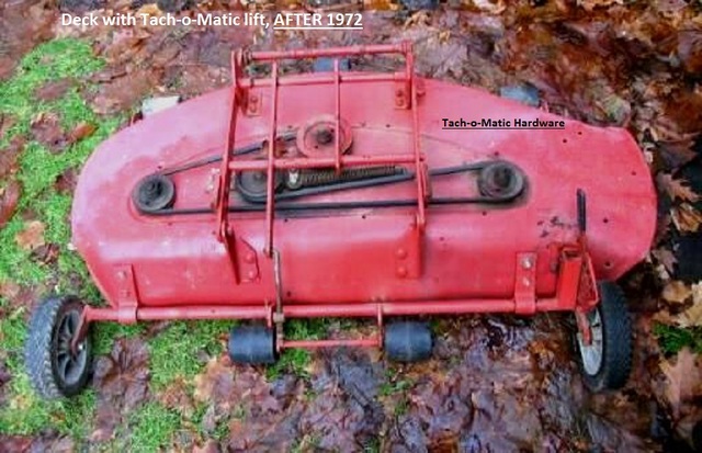

daveoman1966 3,624 #2 Posted September 2, 2015 (edited) Virtually ANY of the 36 42 (side or rear disch) or 48" side disch decks with the Tach-o-Matic lift design will work on this machine....without question. The exception would be decks made for use on tractors with vertical shaft engines. However, they too can be easily adapted to fit...very easy. The over-size 60" deck will not fit, unless you change the front axle. Here is an example of the Tach-o-Matic lift design:The Tach-o-Matic is the LIFT HARDWARE that is bolted to the top of the deck. It is very easy to mount and remove these and they are of universal design.You'd also need the MULE DRIVE that attaches to the front of the tractor.For more info, contact me outside of RS at this email address: (juct clik the link)daveoman@windstream.net Edited September 2, 2015 by daveoman1966 Share this post Link to post Share on other sites
