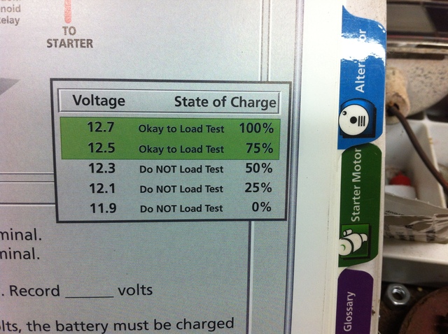

953 nut 68,180 #4 Posted August 30, 2015 You should be seeing 12 + volts at rest and 14 +/- while running. Cleaning all of the battery cable terminals before changing the battery could pay big dividends too. 1 Share this post Link to post Share on other sites

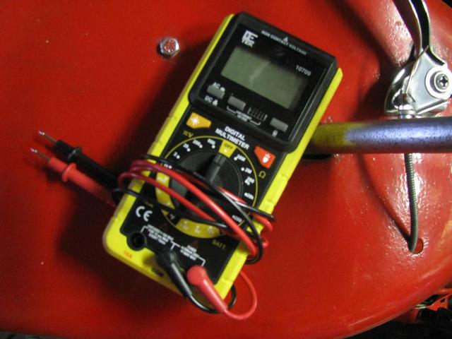

pfrederi 20,999 #7 Posted August 31, 2015 With that many tracgtors you need to take a trip to Harbor Freight and buy a multimeter and a battery load tester. You can get both for less than the cost of a decent battery. They aren't the best items in the world but they will work well enough for our kind of needs. Share this post Link to post Share on other sites
WNYPCRepair 1,924 #8 Posted August 31, 2015 HF has a "good enough" multimeter for about $5 Share this post Link to post Share on other sites
stratostar250 934 #9 Posted August 31, 2015 Guys....dont worry, I have a decent multimeter. Ill throw a known decent battery in it tomorrow and see where the voltages are and report back. 2 Share this post Link to post Share on other sites
squonk 47,780 #10 Posted September 1, 2015 Make sure that " known good battery has at least 12.5 volts in it. If it's less you're already half way to the poor house! 1 Share this post Link to post Share on other sites
