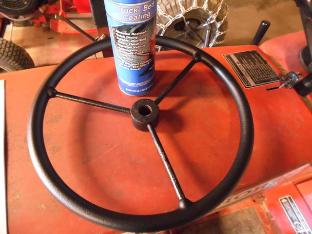

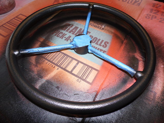

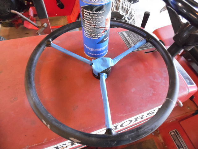

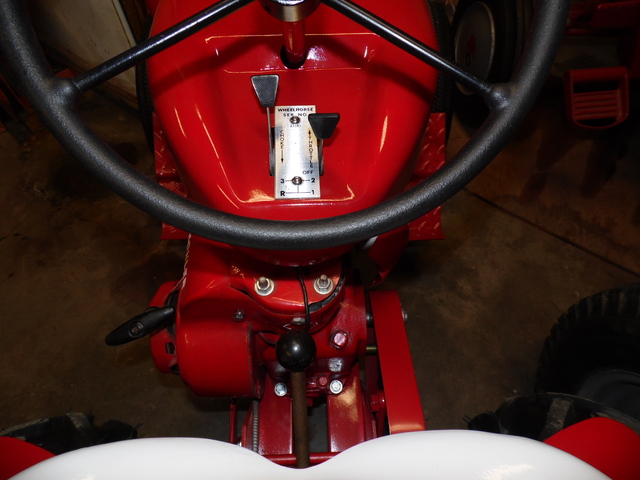

Racinbob 13,250 #1 Posted August 30, 2015 I picked up this steering wheel for my Suburban at the big show. It was decent but did need a little work. I didn’t take any before shots but you all know what happens to these old wheels. After patching deep gouges, cracks, etc. smooth things up and do any reshaping if needed. Clean up the spokes, prime and paint. Mask the finished spokes stopping about 1/16” short of where the plastic coating on the rim started. I used Dupli-Color Truck Bed Coating in a spray can. They make two bed coatings. The blue can that I used and the Bed Armor in the black can. The Bed Armor might be a bit better for a truck bed but I really don’t think it’s best for this application. I held the wheel with a ¾” wood dowel and had several coats on in just a few minutes. Even in this Florida humidity you could actually see each coat dry literally in seconds. I applied enough to get the finish I liked and to blend it into the painted spokes. I love the texture and feel of it and it should be durable. 15 Share this post Link to post Share on other sites

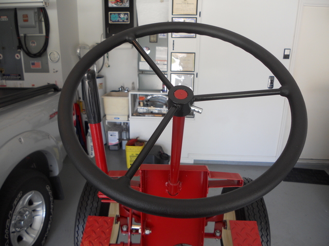

Molon_Labe 731 #10 Posted September 1, 2015 Bob, great minds really do think alike! I did the exact same thing to my Suburban and could not have been more pleased with it. The bed liner holds up as you would expect and should give the old girl another 50 years of good service. 6 Share this post Link to post Share on other sites
Racinbob 13,250 #11 Posted September 1, 2015 If your mind works like mine all the time you should be very worried That looks great. What spray liner did you use. If different it gives the others options. 1 Share this post Link to post Share on other sites
