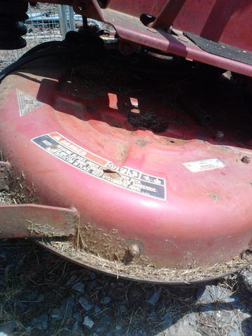

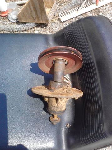

jklapmeyer 0 #3 Posted August 28, 2015 The deck is 36", side discharge. I have attached two pictures also. Forgot to mention this unit has two blades. Share this post Link to post Share on other sites
gwest_ca-(File Mod) 12,348 #4 Posted August 28, 2015 Perhaps it is a 2-blade 38" width of cut? Model 78215http://www.partstree.com/parts/toro/mower-deck-assemblies/78215-toro-38-side-discharge-mower-deck-for-260-series-yard-tractors-sn-3900001-3999999-1993/Garry 1 Share this post Link to post Share on other sites
Don1977 606 #5 Posted August 28, 2015 (edited) I believe what you have is a 38" base. Take a look at the 38" decks on this page.http://www.partstree.com/parts/toro/mower-deck-assemblies/05-38sy02-toro-38-side-discharge-mower-deck-sn-2000001-2999999-19 Edited August 28, 2015 by Don1977 1 Share this post Link to post Share on other sites
jklapmeyer 0 #6 Posted August 28, 2015 Thank you for your replies. The correct model is 78215. Share this post Link to post Share on other sites
