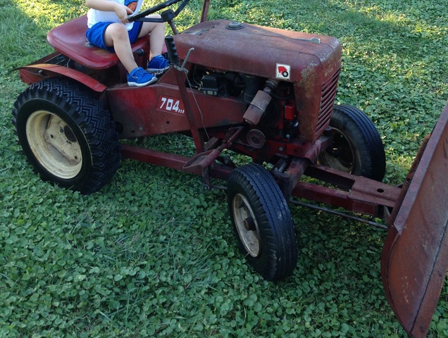

treehorse704 7 #1 Posted August 28, 2015 I want to start off by saying I'm a new member, and new to wheel horse family. I own a small tree company, and last year i was looking for a lawn tractor with some guts to skid around some small logs. I did some research, then stumbled across a 704 with a dozer blade and a mower deck. Completely original, down to the air filter by the looks of it. I purchased it for $300. I flushed the gear oil, oil change, spark plug, filter, etc. yesterday I pulled 12' long, 12" diameter logs for near 5hrs. Then my 3 year old son putted it around the back yard, smiling ear to ear. Thing is proving bulletproof, and special. No drop in oil level, and didn't go through a full tank of gas!I think I am posting in the correct place, but I'm learning how to navigate still.my only problem is 3rd gear slips under load, and my break is worn. Both of these were not my doing. I plan to use this horse like a work horse, and fix it as it needs it. Some advice on how to move forward would be great. Thanks, a lot. 3 Share this post Link to post Share on other sites
Ed Kennell 46,642 #2 Posted August 28, 2015 First...to What a great looking horse. Love that patina.I'm no xpert on your tranny problem, but I'm sure the Stevasauras tranny guru will chime in and offer some help. 1 Share this post Link to post Share on other sites
slammer302 2,157 #3 Posted August 28, 2015 thats a great looking horse and your problem with third gear popping out is sum what common one of the experts will give you more insight on that Share this post Link to post Share on other sites
treehorse704 7 #4 Posted August 28, 2015 Thank you, and I plan to leave the patina until one of my boys wants to fully restore it. Or they will be like me and leave the stories on it. ha 3 Share this post Link to post Share on other sites
Brian01 481 #5 Posted August 28, 2015 that's a good lookin tractor! Share this post Link to post Share on other sites
slammer302 2,157 #6 Posted August 28, 2015 I just noticed the hood ornament i like it gives it sum character Share this post Link to post Share on other sites
Brian01 481 #7 Posted August 28, 2015 lol good eye...I didn't see it either Share this post Link to post Share on other sites

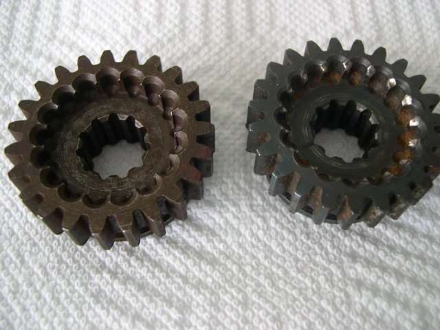

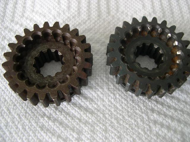

Racinbob 13,054 #10 Posted August 28, 2015 (edited) You can download the service manual right here. You're problem is going to be the Hi/2nd gear, part #3523 and the input gear #3522 may be an issue as well. It's a common problem in these transmissions caused by grinding the gears over the years. The nice thing is that they are really simple to work on. Steve's videos are great so definitely take a look at them. Flush the transmission first and then disassemble. Inspect the gears, bearings, etc. to determine what you need then post it here. You'll definitely want to get all new seals for it. Note the pinned information at the top of this section. It has all the info you'll need for the gears and seals. Your 704 has a 5046 transmission. The brake will be a simple fix by either adjusting as Craig mentioned or, if you need new lining Rmaynard has them in the vendor section here. In any case, when it comes to Wheel Horses you definitely came to the right forum for help.Here's a picture of the 3523 gear. In 3rd the inner teeth mesh with the input gear. The left one is a NOS gear and you can see the teeth screaming to be ground off. The one on the right is worn but still usable especially on a non-worker. I'm betting your gear will be worse. Edited August 28, 2015 by Racinbob 3 Share this post Link to post Share on other sites

stevasaurus 23,763 #16 Posted September 1, 2015 Craig's right...and a little planning here will go a long way. I am pretty sure Racinfool40 is out of those 2nd/3rd fork gears. We do have a couple of show/swaps left...so he may find some. We all know that is what you are going to need for sure...(the input shaft may be alright). I would place a want ad in the classifieds now and try to find that # 3523 fork gear. Someone else just may have one out there. Cost should be anywhere from free to $20 plus shipping. Make sure you get pictures of it and compare it to Bob's pictures above. Let us know what you find. 1 Share this post Link to post Share on other sites
Racinbob 13,054 #17 Posted September 1, 2015 Also including a picture of the 3522 input gear would be a good idea. That may be chewed up too. 1 Share this post Link to post Share on other sites
