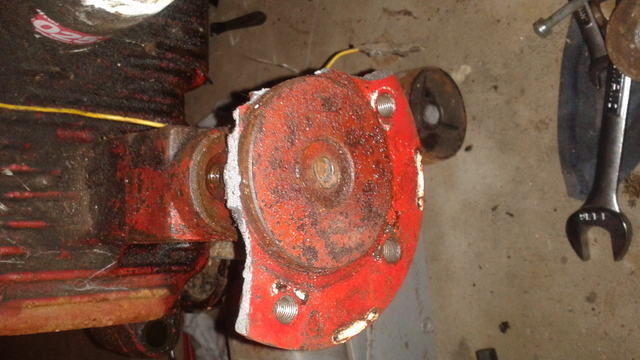

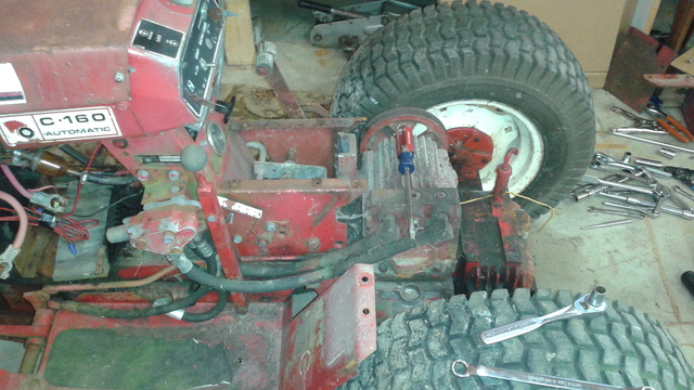

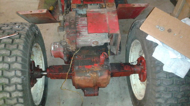

BOB ELLISON 2,983 #1 Posted August 27, 2015 Ok guys especially chorusguy for saying I should save my C160 from parting out. I need help on this tractor. I am ready to open up the 5088 transmission to find out why the left axle is coming out. I know I have to pull off wheels and hubs and I have seen how to do it with an old hub that I don’t have. well and I broke the hub trying to get it off. tried a 3 arm gear puller that didn't do it so I took left side hub with 5 bolts and large bolt in middle and it broke hub as you can see. And does this thing really use 10w30 motor oil for Trans and hydro drive? Found this in manual NOTE: It is not necessary to remove the hydrostatic unit if only the transaxle is being serviced. TRANSAXLE DISASSEMBLY The transmission case is held together with six bolts. Disassembly may be made from either side, leaving the gears intact in the opposite side. NOTE: It is not necessary to remove the hydrostatic unit if only the transaxle is being serviced. 1. Remove both wheel hubs by loosening the lock nuts and set screws. Slide the hubs from the axle. A special wheel puller may be required. 2. Remove the woodruff keys and file any rough edges from the key slots and the ends of the axle. 3. Remove the six bolts holding the transmission case halves together. 4. Lightly tap the half to be removed with a plastic or rawhide mallet to break the seal. Slide the case-half off, the axle carefully to avoid damaging the oil seals. 5. Remove the old gasket and carefully clean the sealing surfaces I don’t know what will fall out when I do this. If I do get it apart do I have to pull the pinion gear to see if snap ring is broken or axle is damaged? I don’t know what to expect because I never did a transmissions before. And what should I replace after I do find it to be good, wheel seals, filter, gasket for Trans this is a no brainer. Someone said the parking pawl would most likely be bad. I have the manual but I need a picture book showing what order to remove parts and what to take off. I did see a diagram of taking off half of the Trans but I can’t find it again. I have to clean a lot before I can open it up and the parts I need where I can get them. I want to check the trans and see if it is a easy fix or replace it.update drained trans and no metal bits came out oil looked dark but good .I used a magnet and got no metal out ofoil so far so good just got to get the rest of the hub off ,got any ideas. Share this post Link to post Share on other sites

BOB ELLISON 2,983 #3 Posted August 28, 2015 thank you 953 nut but I already read that whole post. I tried with a puller and broke a peace off soI went with the hub and 5 bolts to hold a large bolt in the middle and it broke as inthe picture, I will make something to go on back of hub may need to heat it.or take off that half of the transmission and try it press if off .orcut it with a cutoff wheel with out hitting axle Share this post Link to post Share on other sites
chorusguy 227 #4 Posted August 28, 2015 They really do use 10w30 as hydraulic fluid. I have read that some earlier models used automatic transmission fluid (atf) however don't switch. If there is motor oil in it use motor oil again. I think there is a screen filter inside that could catch metal scraps if there are any. Don't want to burst your bubble but if there are bits and pieces they could be caught there. Make sure you clean that out. Also use the specific filter for the tranny. Or the Napa equivalent. Something about a bypass. The parking pawl is made of bronze I think. Never had a problem with my 3 160's. They all work. I bought a parts tractor and suspect the parking pawl is screwed in that one. Lever doesn't move but the tractor does. Looking forward to seeing your progress Share this post Link to post Share on other sites
