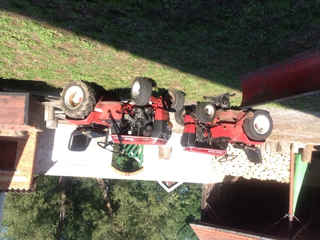

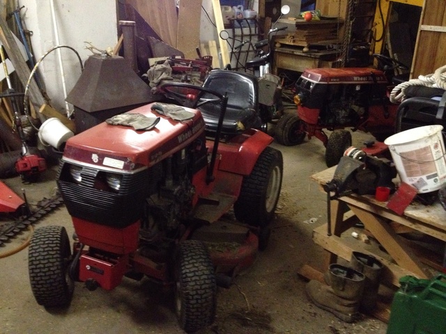

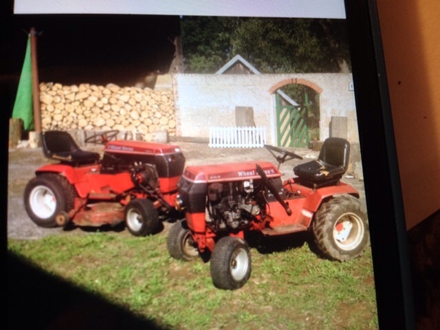

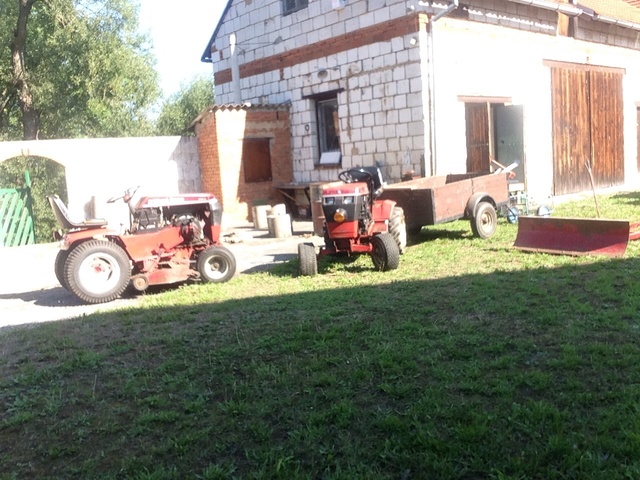

Shaun Liddiard 4 #8 Posted September 1, 2015 Hi thanks for advice etc got impatient ask them clever Czechs and they produced a belt off the shelf... Makers name Rubena Profi ... No's on it A2480Lw 13x2450 Li A961/2 el L=L.. 140 cz krowns ... In English that is less than £5 so bought two it's just a fraction of genuine one at £30 plus ... I jus put little old lady through hell as so overgrown ... Not a murmur from belt .. Tractor must be turning 30 soon ... And goes to work regular never had any issues with the rest of this great little machine ( I mean zero maintainance) can only remember changing oil last about 10 years ago ... Before you all tell me it's this weekends job !! Will try to attach pics Share this post Link to post Share on other sites
