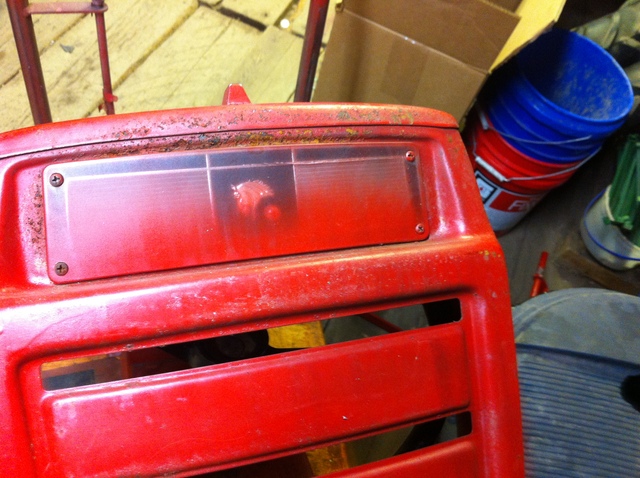

squonk 47,999 #1 Posted August 25, 2015 Starting to get the winter sheet metal ready for Ezra. Got another hood and it's complete except someone decided to paint the headlight lens and hood ornament. Why do people do this? 2 Share this post Link to post Share on other sites
KC9KAS 4,746 #2 Posted August 25, 2015 "Why do people do this?"Uhhhhh. Lazy, don't give a darn, stupid, I could go on......... 1 Share this post Link to post Share on other sites
daveoman1966 3,884 #3 Posted August 25, 2015 You MAY be able to save that lens.. New are about $40.Use a little bit of lacquer thinner to dissolve the paint. If you scratch the lens, slowly sand out the scratch with 1000 grit sand paper....then buff it with crocus cloth 2 Share this post Link to post Share on other sites
JackC 619 #4 Posted August 25, 2015 That lens is worth saving by carefully removing the paint over spray. It looks to be the genuine older lens rather than the newer decal lens. Those are very hard to find without cracks. 1 Share this post Link to post Share on other sites

squonk 47,999 #9 Posted August 25, 2015 The hood is rusty and pitted! lacquer thinmer got it off. The lens is not one of the raised horse head lenses, but it's a good lens 1 Share this post Link to post Share on other sites
