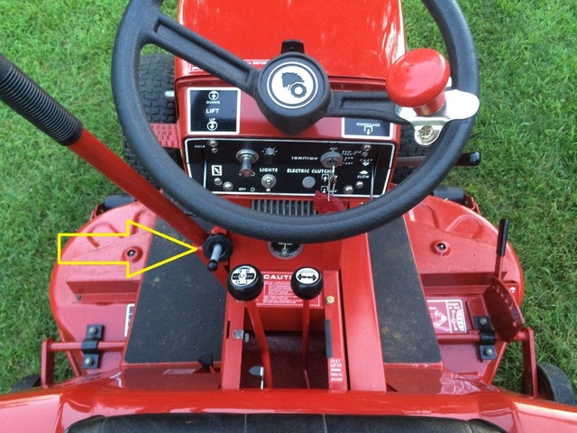

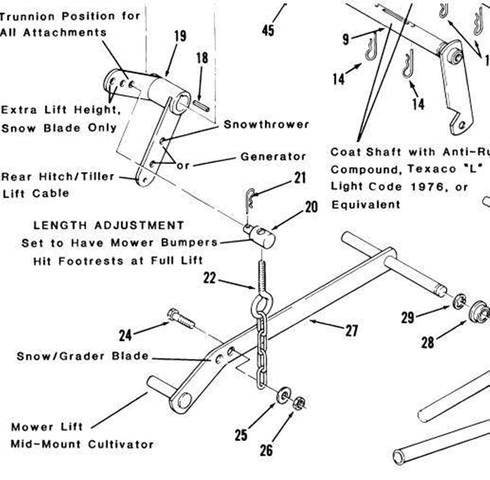

The rear wheels set the height of cut along with the Height adjuster shown by hte yellow arrow. You also may want to look at the second picture and make sure everything is assembled in the correct holes. And the manual may come in handy as well. May not be for your exact unit but the process is the same regardless.

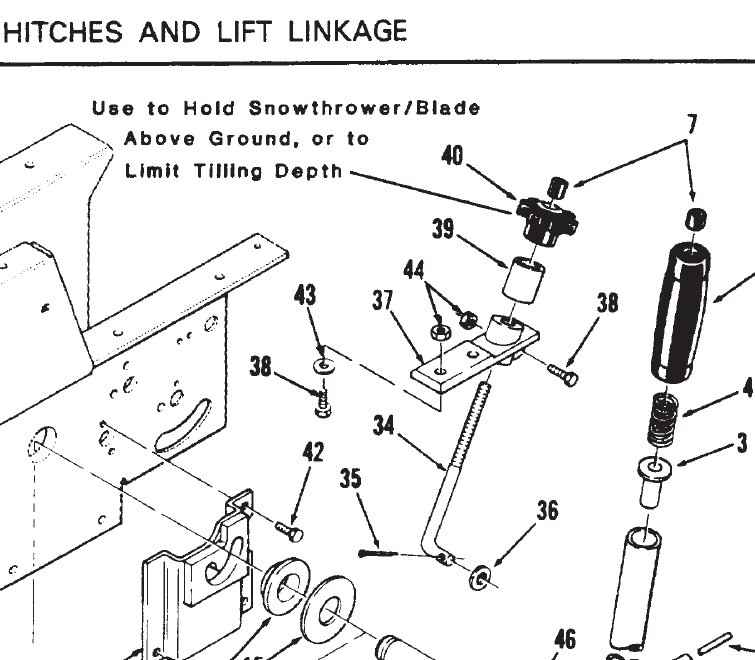

Technically you aren't supposed to use the height knob for mower adjustments (per the manual), but many people do it anyway (I did for the 15 years before i read the manual).
I cant seem to find where I read that it said it was "not recommended" but note in this part of the picture it says nothing about mower height:
Untitled.thumb.png.deb67be334ffa1c638f59

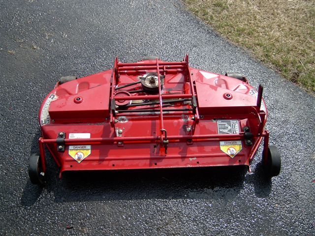

Did you set the leveler adjustment on the back of the mower (about dead center of second picture @MikesRJ posted of the 42" RD deck)? The front of the blade (when aligned parallel to the tractor) should only be 1/8 - 1/4" below the rear. Sometimes the front can be set down pretty far and make its seem like the adjuster isnt working well. Edited by bmsgaffer
