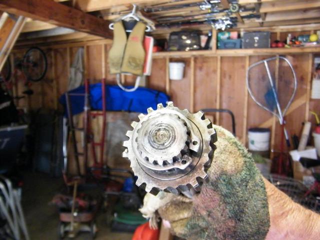

stevasaurus 23,861 #2 Posted August 23, 2015 (edited) The axle is splined for a few inches...the axle gear slides onto the spline...a "C" clip is placed in a groove on the end of the axle that holds the axle from pulling out of the axle gear. It is an easy fix, but it is labor intensive...you have to drop the trans and open it. Once open, you can pull out the differential and open that...examine the damage (if any)...place a new clip and put it back together. The old clip should be in the differential, not floating around the rest of the tranny. You may not have any damage...you may have some teeth broken in 1 or more pinions...maybe a bad axle gear. Any of those parts are available for not much money. This is definitely fixable for not much money. In the picture, you are looking at the end of the axle and a bad axle gear...and that pesky "C" clip.If you have a chance to pick up a 312-8 for a good price, I would not let a "C" stop me...might be able to drop the price a little more. We are here to help you through the process and find parts if you need. Edited August 23, 2015 by stevasaurus 4 Share this post Link to post Share on other sites

wallfish 20,723 #7 Posted August 23, 2015 Wow Steve, that gear is missing more teeth than a meth head. What caused that? 1 Share this post Link to post Share on other sites
stevasaurus 23,861 #8 Posted August 23, 2015 (edited) Sounds like your addiction is not letting you sleep much at night. Thanks for the background. $375 does sound high if it is just the horse...you could end up putting $100 in that trans, depending on what may be broke inside. $300 would give you some money to fix the trans. John, that gear is out of a 10 pinion, limited slip transmission. One of the pinions got caught, not keeping up with the program, and broke some teeth...guess where they got caught. Got the new parts from Mike Biser, and the trans is as good as new. Edited August 23, 2015 by stevasaurus 1 Share this post Link to post Share on other sites
