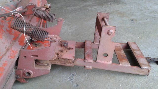

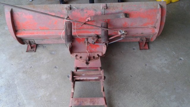

BOB ELLISON 2,983 #1 Posted August 18, 2015 I got this when I bought my wheel horse 520h,the guy said it was for the tractor ,But I told him it is not fora wheel horse because it was not long enough to hook to the back axle bracket, and the lift would notwork. I couldn't not take it since I was getting it for free. Maybe some one would recognize it .it is very heavy made, might be able to add to it so it would work on a wheel horse with a little weldingor sell it to some one for the right type tractor . it had a bar attached with a bolt onthe back about 2 feet long you can see a little of it on side photo . Share this post Link to post Share on other sites
WNYPCRepair 1,924 #2 Posted August 18, 2015 How long is the piece welded on at the very end? (right side on the bottom picture) Share this post Link to post Share on other sites
daveoman1966 3,884 #3 Posted August 18, 2015 I'm thinkin it is for a Bolens or maybe a Cadet. Share this post Link to post Share on other sites
Ed Kennell 47,612 #4 Posted August 18, 2015 Looks like it could be a home made mount to fit a front attach-a-matic with a snowblower style push/lift bar . 1 Share this post Link to post Share on other sites
DennisThornton 4,773 #5 Posted August 18, 2015 I think I recently saw something real similar and pretty sure it was a Bolens. Not like any WH I've seen. Share this post Link to post Share on other sites
WNYPCRepair 1,924 #6 Posted August 18, 2015 Looks like it could be a home made mount to fit a front attach-a-matic with a snowblower style push/lift bar . That is what I was thinking Share this post Link to post Share on other sites
daveoman1966 3,884 #7 Posted August 18, 2015 The MAY be from a dinosaur Sears model ST-12 or ST-10 or the like. They were made heavy like this. Share this post Link to post Share on other sites
BOB ELLISON 2,983 #8 Posted August 18, 2015 I think I found it after searching all over the internet. it is a Simplicity 1690089 - 46" Snow Plow & Dozer Blade Hitch.but I think ekennell is right some one tried to modify it for a wheel horse or something they welded it very good.it has the same type handle to unlock the latch to turn the blade. thank you allhttp://www.michaelstractors.com/forum/topic.asp?TOPIC_ID=186 Share this post Link to post Share on other sites
DennisThornton 4,773 #9 Posted August 19, 2015 Bob I think you found it. Well, at least what it was and at least who made the blade. Still don't know what it would fit but it sure won't fit a Simplicity anymore. Here the Bolens picture I was thinking about. Similar but not it. I wonder what it fits now? And how did you find the Simplicity pdf? Share this post Link to post Share on other sites
BOB ELLISON 2,983 #10 Posted August 19, 2015 Dennis I went looking on google for plow pictures and found one that looked close to it and from there I found this number Allis Chalmers Snow Plow/Dozer/Grader Blades 1690089 - 46" Snow Plow & Dozer Blade Hitch.so I googledthis number and it says it is a Simplicity 1690089 - 46" Snow Plow & Dozer Blade. I even found a manual for itbut I am attaching a pdf file and you can see it is the one. the picture you have is just like the piece inpicture 2 that is on this plow. a pipe bolted to the back on mine it is square but about the same Length plow.pdf plow.pdf plow.pdf Share this post Link to post Share on other sites
DennisThornton 4,773 #11 Posted August 19, 2015 Bob, all three of your attachments are the same.So what it was used on is still a mystery? Share this post Link to post Share on other sites
Brian01 481 #12 Posted August 27, 2015 If its heavy built, I say fab it up to fit whatever you wanna use to push it Share this post Link to post Share on other sites

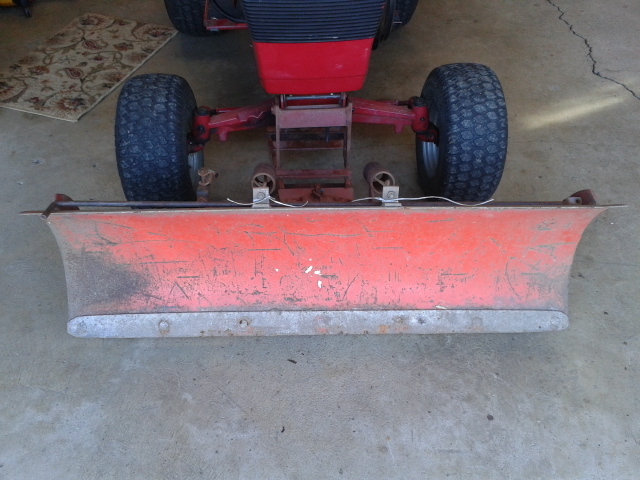

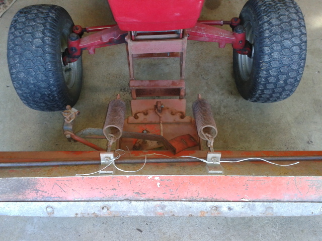

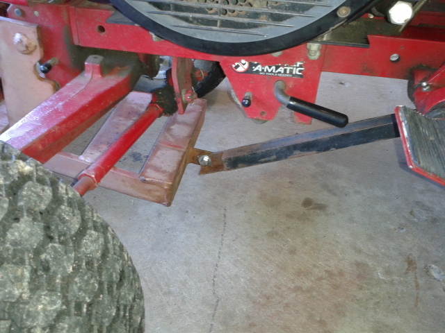

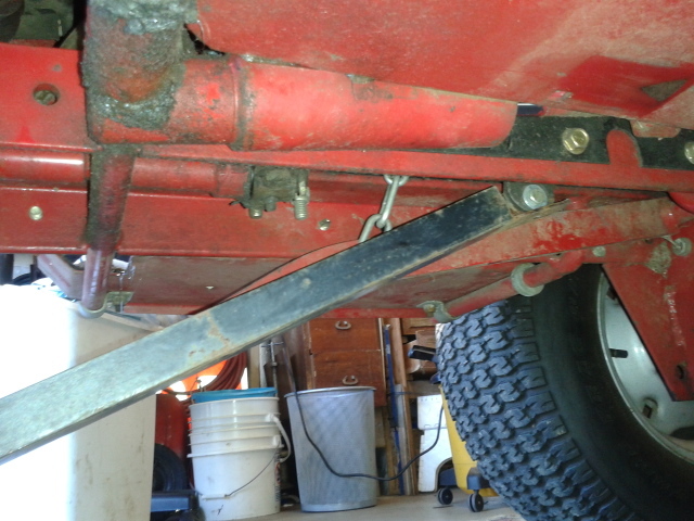

BOB ELLISON 2,983 #13 Posted November 4, 2015 (edited) OK GUYSI just had to find out if this plow fit. like the guy I bought it from said the old man used it for plowing with the520h I bought from him .well it did hook up to the front attach-o- matic just like ekennell said it looked like. added thebar that came with it and it lifts and lowers perfectly ,and I thought he was a nut. boy do I feel likethe dummy. just thought you would like to know...it will not go in last notch's it hits tire , it can only use center and 1 notch left and right or 3 notch's. but it is angled enough with that. I kinda like it this way all the push is on the front of the frameand not on the axle and plate. what do you guys think ?? I'm not going to paint it wh red it will be orange Edited November 4, 2015 by BOB ELLISON 2 Share this post Link to post Share on other sites
Ed Kennell 47,612 #14 Posted November 4, 2015 (edited) I like it. Looks like it has excellent leverage for easy lifting. A couple things I may be concerned about is the additional stress placed on the trans axle mounting plate, although They are very easy to beef up with backing plates.The other is with the high attachment point, the front wheels may tend to lift and the push / lift rod will see a lot of force when pushing hard or if you hit a solid object. I can't be sure, but it looks like the mount frame will hit the axle before it hits the tie rods. Edited November 4, 2015 by ekennell 1 Share this post Link to post Share on other sites
BOB ELLISON 2,983 #15 Posted November 5, 2015 EkennellThis 520h has the axle plate reinforced with a 1/4 in plateFrom the factory .i don't think it will hurt it there.time will tell.i don't think I will have to use it with the c160 that i just finished. Share this post Link to post Share on other sites
