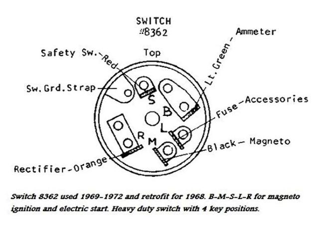

CasualObserver 3,416 #1 Posted August 15, 2015 Found this switch in my parts boxes and can't for the life of me remember what it was for. Anyone know offhand from the letters? Clockwise from the top. .. S. B. L. M. R. Thanks. Share this post Link to post Share on other sites
gwest_ca-(File Mod) 12,489 #2 Posted August 15, 2015 #8362Garry Share this post Link to post Share on other sites
CasualObserver 3,416 #3 Posted August 15, 2015 Thanks Garry. Guess that would be Kohler , 10-12-14 horse models? Sent from my SM-G900P using Tapatalk Share this post Link to post Share on other sites
gwest_ca-(File Mod) 12,489 #4 Posted August 16, 2015 (edited) That's correct. I tried to list models that used it herehttp://www.wheelhorseforum.com/files/file/1209-wh61-90-134-ignition-switches-1972-modelspdf/This was before they used starter solenoids.This service bulletin did not identify the switches it covered but was able to do it through the process of elimination. Hope it is correct.Garry Edited August 16, 2015 by gwest_ca Share this post Link to post Share on other sites
squonk 48,164 #5 Posted August 16, 2015 Why would those Kohlers use a magneto? Aren't they battery ignition or am I forgetting some models? Share this post Link to post Share on other sites
gwest_ca-(File Mod) 12,489 #6 Posted August 16, 2015 Believe they called it breakerless ignition at the time.Garry Share this post Link to post Share on other sites
