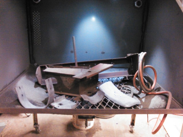

JPWH 6,546 #27 Posted September 26, 2015 Still have a little work to do but I now have a working blast cabinet. 2 Share this post Link to post Share on other sites

JPWH 6,546 #30 Posted October 17, 2015 I finally got all the bugs worked out and the cabinet is working great. I use a bucket feed siphon gun in a water jug from a water dispenser turned upside down with a hole drilled in the bottom for the tube. When the jug is empty I dump the media in a 13 gal trash can and pour the media through a sifter I made from a bucket then use a funnel to pour it back in the jug.The plexiglass lens is working good as well. I installed a metal window screen I cut down to fit into brackets about 3/4 inch below the window. I clean the screen and window while waiting for the.media to go thru the funnel into the jug. The whole process of recycling the media and cleaning window takes.about 20 minutes. I am going to add a light to each side at the front. That will eliminate shadows when working on larger items. 1 Share this post Link to post Share on other sites
