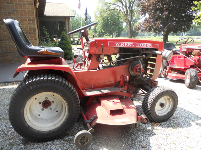

Racinbob 11,991 #14 Posted August 12, 2015 Here's a pic of a 1976 B-80 'converted' to a C-160. I bought it as a B-80 brand new. I bought the headlights when I bought the tractor. I installed a new K-341 and 23-8.50 rear tires. In 2000 I sold it when we moved here. Kinda a long story but about a year ago I discovered that the current owner was the neighbor of my daughter and her family in Walkerton, IN. It was still almost like new when I sold it in spite of how hard I worked it and it saddened me to see the shape it's in now but it was so amazing that I got to see it again. The Commando 800 (1972) in the background is my grandsons. I restored it for him several years ago. The rear tires on it are the 22-7.50 that were originally on the B-80. Also keep in mind the other differences between the B and C series in that era but yes, the 77 and older B's were just as capable if the horsepower was there. The 76 and 77 even had the 8 pinion diff and 1.125 axles. Not sure prior to that. 4 Share this post Link to post Share on other sites

DennisThornton 4,771 #16 Posted August 12, 2015 That does a real good job of answering several of my questions about Bs vs Cs. And yes, I goofed, there's no C-80 listed anywhere that I can find. Though I'm hesitate to say anything definite about WHs anymore. Just learned about 754s!What about the vertical shaft Bs? Weaker trannys? Other cost cutting areas?Thanks! 1 Share this post Link to post Share on other sites
Racinbob 11,991 #17 Posted August 12, 2015 Most definitely weaker transmissions, frames, etc. Designed to compete with the big box stuff. Fine for mowing lawns but iffy with most other attachments. 1 Share this post Link to post Share on other sites
