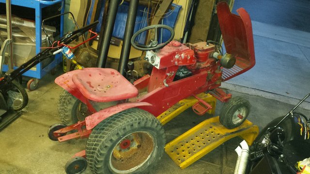

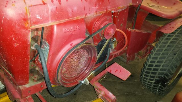

swade41 7 #1 Posted August 11, 2015 Just bought my first Wheelhorse but have admired this style for 20+ years after seeing my first rolling chassis at an auction. Not sure on the exact year but has a Kohler 181S spec 30108A engine, that needs carb rebuilt. Where can I get a rebuild kit for it to stop the gas from coming out of carb. The float seems free and level to carb body which was my first thought and a rebuild kit couldn't hurt anyways. 1 Share this post Link to post Share on other sites

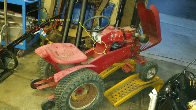

MikesRJ 563 #5 Posted August 11, 2015 (edited) What numbers are on your engine? The tractor serial number tag should be on the dashboard riser below the dashboard. See image below.TRACTOR MANUAL: http://www.mywheelhorse.com/graphics/file/Tractors/TR_1962_502-552-702_502P.pdfTRANS MANUAL: http://www.mywheelhorse.com/graphics/file/Transmissions/Transmission_Uni-drive_1958_-_1982.pdfENGINE SERVICE MANUAL: http://www.mywheelhorse.com/graphics/file/Engines/Kohler_K91-141-161-181-241-301-321-341_tp_2379_SM.pdf Edited August 11, 2015 by MikesRJ 1 Share this post Link to post Share on other sites

swade41 7 #7 Posted August 11, 2015 I reckon it's not the original engine then, defiantly says 181S spec 30108. I'll look for that number under the dash after dinner. 1 Share this post Link to post Share on other sites
MikesRJ 563 #8 Posted August 11, 2015 (edited) You probably reckon correctly. The K181 engine didn't come standard on a Wheel Horse until 1964 on an 854. The engine you have, based on the Spec number, is probably off (or a replacement for) the 1964 854 or a 1965 855 or 875-Auto. Edited August 11, 2015 by MikesRJ 1 Share this post Link to post Share on other sites

swade41 7 #10 Posted August 11, 2015 Thanks for those manuals, nothing under the dash on the riser, couple holes where an id plate might have went. So anyone have a direct link to a carb kit for it, like to get this baby running ? Share this post Link to post Share on other sites

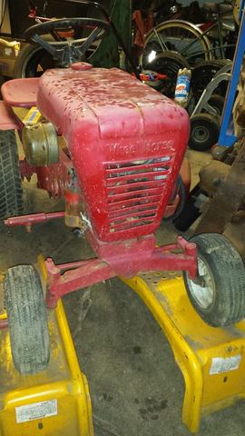

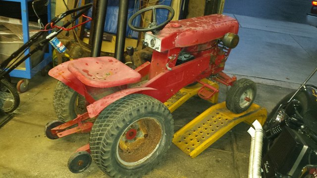

prondzy 3,890 #16 Posted August 12, 2015 (edited) Welcome to red square and glad to hear you found a beautiful tractor! I'm not a serial number or spec number decoding guy but by the look of your tractor you have a 854. If it is an 8hp repower the the other model numbers are 753, 653, 754, it can't be a 702 the front axle and brake pedal are 1963-1964. A 702 would have a square front axle and a pointed flag brake pedal. My guess is 854. If you take a little brake cleaner or laquer thinner on a rag you might br able to wipe off the square on the belt guard and reveal the model number. Hope this helps Edited August 12, 2015 by prondzy Share this post Link to post Share on other sites
bmsgaffer 2,071 #17 Posted August 12, 2015 I would vote 854... I think the spec number is correct for that, isnt it? Share this post Link to post Share on other sites
Jake Kuhn 1,600 #18 Posted August 12, 2015 Also agree on 854. Share this post Link to post Share on other sites
