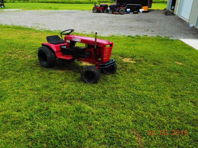

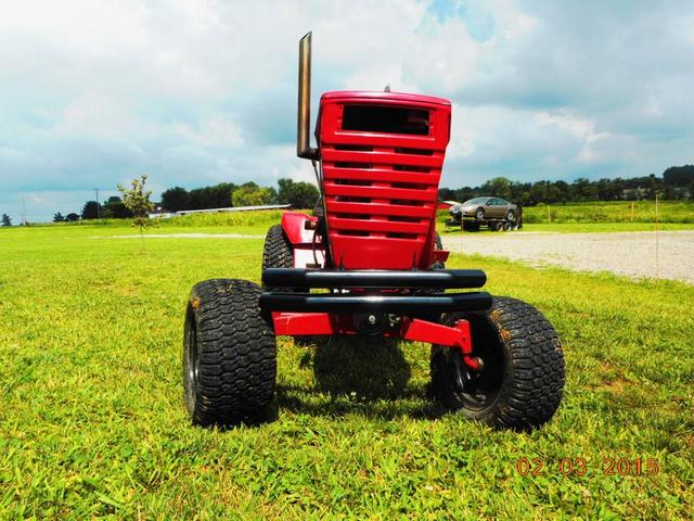

Ethan and Randies horses 65 #1 Posted August 11, 2015 heres the custom brush guard/bumper I made yesterday for my a-90 special.what do you think? 6 Share this post Link to post Share on other sites

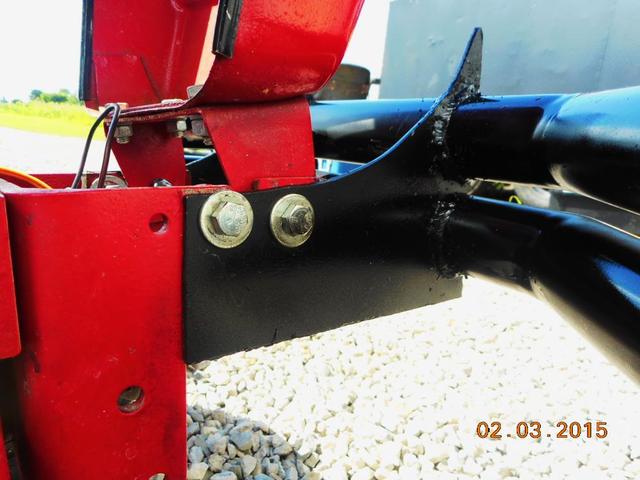

DennisThornton 4,773 #3 Posted August 11, 2015 Need a close up of how you mounted it. Or maybe with it off... Share this post Link to post Share on other sites
DennisThornton 4,773 #4 Posted August 11, 2015 Some nice sharp bends! How'd you do that? Did you lengthen the tractor? Share this post Link to post Share on other sites

Ethan and Randies horses 65 #6 Posted August 11, 2015 it was extended 14 inches.the bends on the pipes?if so I cut them on the metal cutting bandsaw at an angle then welded then ground down heres how it is mounted that curve was cut with porta band then sanded Share this post Link to post Share on other sites
Kegler 68 #7 Posted August 12, 2015 Very nice! If you needed extra weight those could be filled with something (sand, lead, concrete) before final assembly. Share this post Link to post Share on other sites
DennisThornton 4,773 #8 Posted August 12, 2015 Cutting them first was sharp and by golly you certainly did a nice job grinding the welds on the pipes! And Kegler had a nice idea of filling them with lead! Share this post Link to post Share on other sites
Ethan and Randies horses 65 #9 Posted August 12, 2015 yea I never thought about filiing it great idea! Thanks Dennis I ground them with an angle grinder then sanded them with the belt grinder. Share this post Link to post Share on other sites
DennisThornton 4,773 #10 Posted August 12, 2015 Is the tractor stretched? It looks loooong! But everything else in the background looks normal... Share this post Link to post Share on other sites
Ethan and Randies horses 65 #11 Posted August 13, 2015 yes it was stretched 14 inches I just replaced the old transaxle with a hydro tore the gears out of the old one Share this post Link to post Share on other sites
