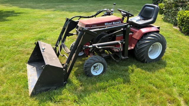

Rexemouse 88 #33 Posted August 16, 2015 Thanks everyone for the feedback, Iv'e been working the snot out of it this past week clearing land behind my house. It does an awesome job of pealing large pricker bushes right out of the ground. I will get some dirty pictures posted once I get the ag's and weights on it.I believe the tractor sits slightly higher in the front due to the 520 front axle swap. It sat perfectly level with the regular 416 front axle. I created a post awhile ago for the hub swap http://www.wheelhorseforum.com/topic/57457-how-to-trailer-hub-conversionupgrade-for-520h/. 2 Share this post Link to post Share on other sites

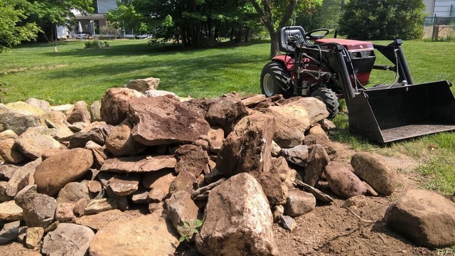

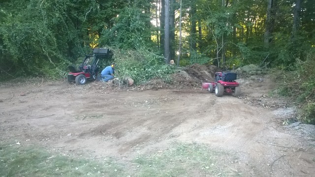

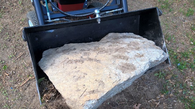

Rexemouse 88 #38 Posted August 22, 2015 I've been using the loader to clear a large area behind my property. The area is full of nasty bushes, huge vines, fallen trees, and large mounds of stubborn dirt. I have worked this little loader so hard and it doesn't seem to care. I don't think I can break it if I tried. Here is a video of Tunaslayet and I moving a huge rock that we pulled out of the mini jungle. I'm not sure what it weighs, but it is seriously heavy.https://www.youtube.com/watch?v=utwPdprSvyEHere we are moving a large mound of stubborn dirt. We probably moved 10-15 yards of dirt in just a few hours (2 evenings after work). https://www.youtube.com/watch?v=eq1whwMtxjEThanks everyone for the support. Thanks Dennis for the 416-8. It plows like a champ. 2 Share this post Link to post Share on other sites

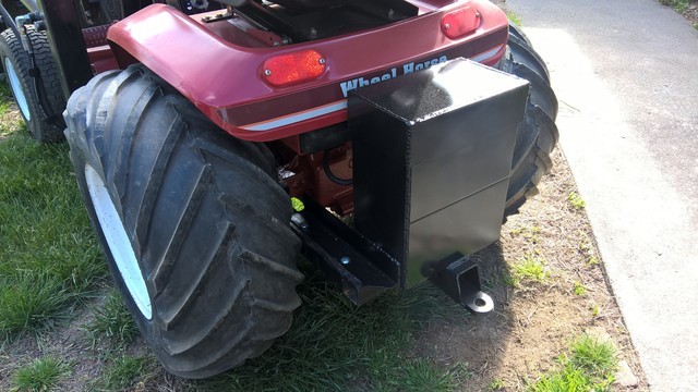

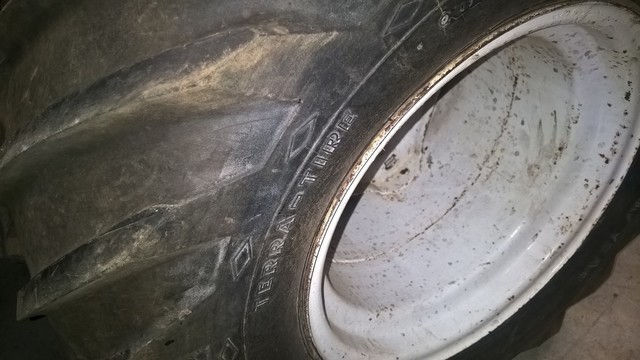

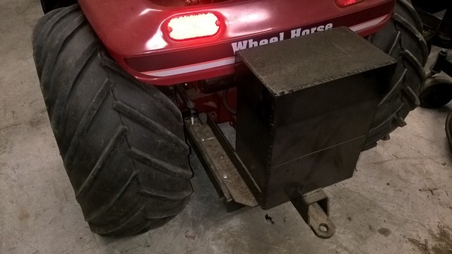

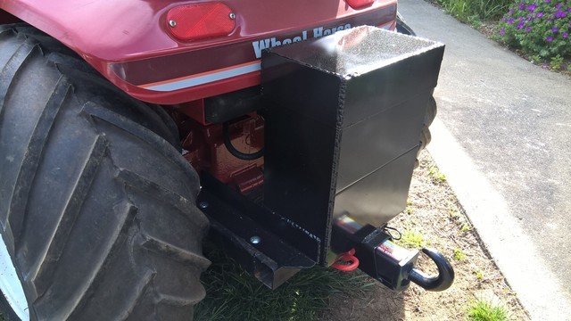

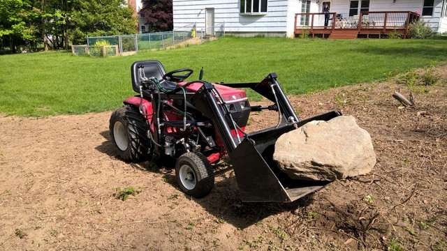

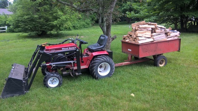

Rexemouse 88 #39 Posted June 6, 2016 (edited) It’s been almost a year since I built my 312-8 loader and I wanted to share my experience. This tractor has been invaluable to me and I find new uses for it almost on a weekly basis. Upgrading the rear wheels to 26x12 Ag’s is by far the best modification i made. They provide insane traction, increased travel speed, and make the loader way less tippy. They also look great. This mod requires raising the seat pan 1” and using wider rims with the correct offset. 520rims are ideal but can be hard to find. The rims on my tractor are fabricated from two wheels (notice weld seam). Filling the tires makes a huge difference! The momentum of the fluid is very noticeable when plowing or plunging into loose dirt. The 26x12 wheels can hold almost 100lb of washer fluid each. I am currently not using wheel weights and I have yet to get stuck. I was previously running 23x8.5 AGs (unfilled w/ 50lb weights) and had serious traction issues, even with light bucket loads. Turf tires are useless. The 520 1” spindles and gear reduction steering are absolutely essential. This setup is so solid and certainly not a weak point. The amount of weight in the bucket is most noticeable in the steering. Even with the gear reduction system, the tractor needs to be moving to steer. It is important to know the limitations of the machine. I actually blew my differential by testing the traction. I bought these good year 26x12 super-terras used from a guy in CT. They were knife-sharpened to increase traction for pulling. The differential broke in 1st-low while peeling up un-disturbed earth with my bucket. This machine can easily load full buckets of loose-dirt and stone, but really shouldn’t be used for any real ground engagement IMO. What I love most about these tractors is that I was able to replace the transmission in less than 4 hours. I have used the snot out of this machine. It is awesome for what it is and will suit my needs for years to come. Thanks, -Justin These old wheelhorse carts are huge and take a heavy load! Was gonna sell it, but i am finding too many uses for it. ^Loader as is sits today. AG's up front simply for the looks. Its definitely pretty worked and dirty. ^These were all pulled out of the woods behind my house. Couldn't have done this without the loader. ^ I moved this rock no problem. Its a giant. ^ I moved this rock too. ^ standard hitch added. All the parts are from harbor freight. ^ I bough this hitch because it had the lower mount I need for towing my cart. ^Knife-sharpened endges. Notice weld seam in rim. ^ Tractor with 23x8.5 AGs. Edited June 6, 2016 by Rexemouse 10 Share this post Link to post Share on other sites

Rexemouse 88 #42 Posted June 6, 2016 Jim, That is a good point about the trasmission. The 312 is from the 90s and did have the 1-1/8 axle 8-pinion diff. I replaced it with an identical transmission from a 416-8. Regarding your engine choice, I find the single 12 to be sufficient for everything I do. A 14 or 16 single would be my first choice for a loader. The singles are extremely reliable, fuel efficient, and much quieter than the twins. They also like to sit and idle, which i find myself doing a lot. I just love the quiet and unremitting heartbeat of a single kohler while manually loading the bucket or tying up some roots/ vines to pull out. Although a 20HP Onan chugging through 2 feet of snow is a sound I cant get enough of. Thanks for the feedback, -Justin 4 Share this post Link to post Share on other sites
