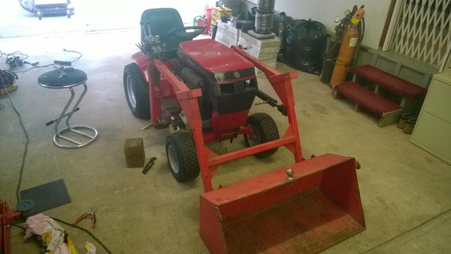

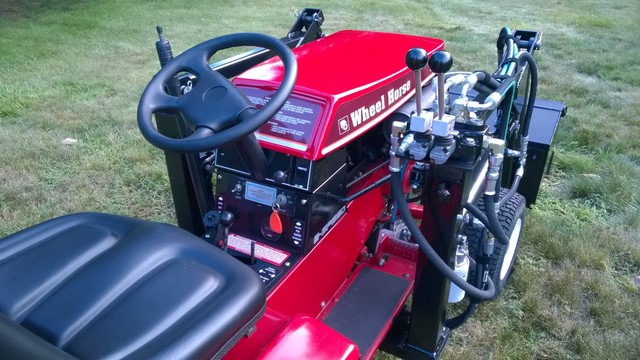

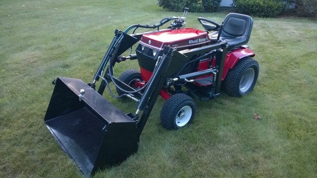

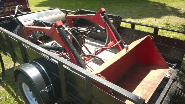

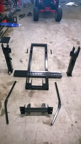

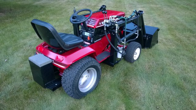

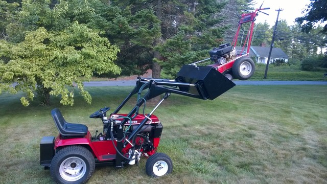

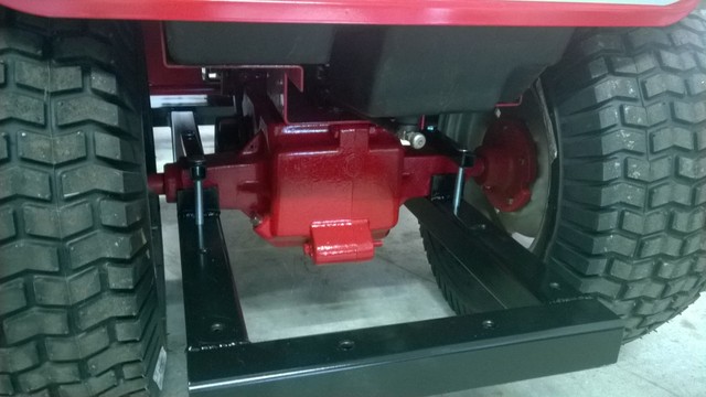

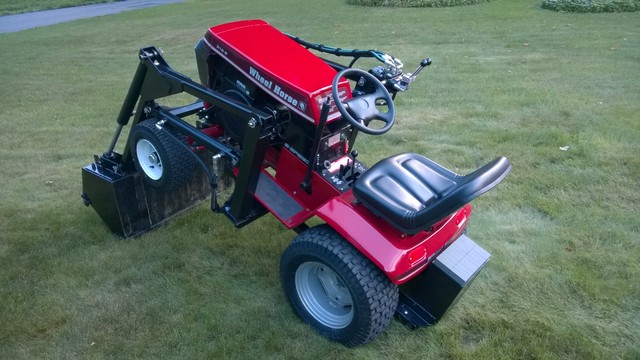

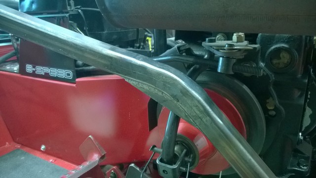

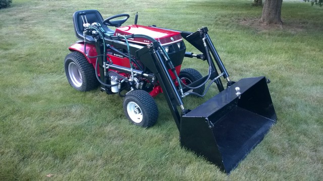

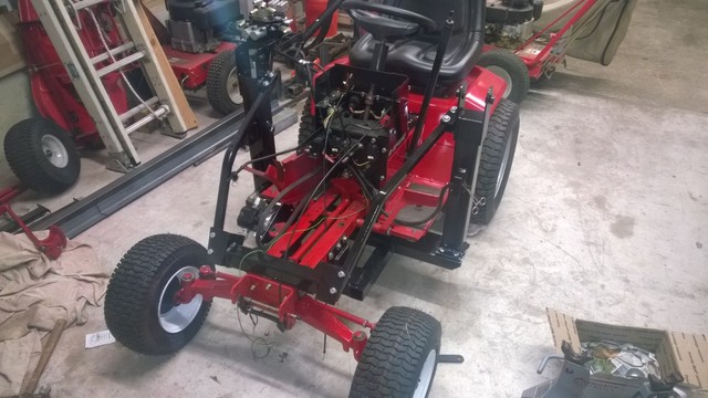

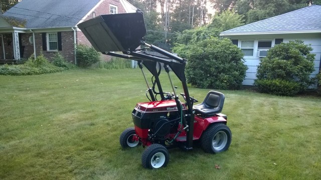

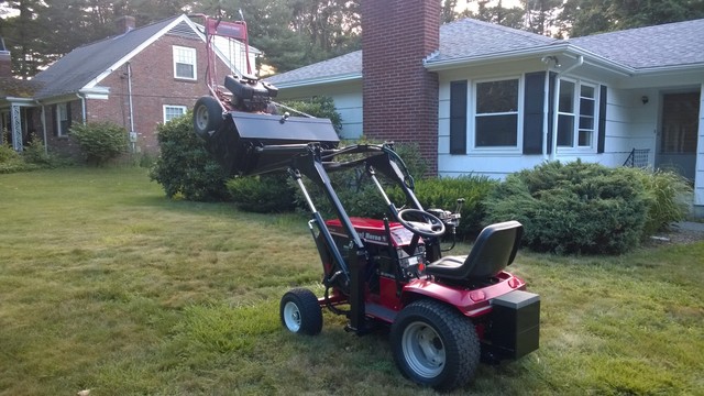

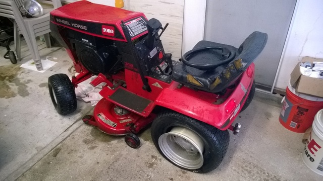

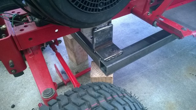

Rexemouse 88 #1 Posted August 6, 2015 (edited) This horse was found upside down in a dumpster by my friend(tunaslayet). He brought the oil-covered 312-8 to my house with a crushed hood, broken steering wheel, and crushed center console. The hour meter read around 1000 hours, but the engine ran with little effort and the transmission shifted smoothly. I quickly began disassembling the horse and fixing/replacing any damaged parts. Sourcing a steering wheel proved to be a challenge, so i retrofitted a boat steering wheel which came out great and was very inexpensive. I cleaned up and repainted the entire tractor and freshened it up with throwback redo-your-horse stickers and fresh turfsavers. I initially began to set this up as the mower that it once was, but shifted my focus to creating a front end loader after my friends father hooked me up with a great selection of hydraulic equipment in exchange for a custom cabinet. I quickly found a loader on craigslist in Maine. The loader was properly sized, in great shape, missing most of the hydraulic components, and well built from PF engineering plans. I quickly picked up the required steel and began fabricating. Here is the 312-8 the day I got it. The loader on the day I bought it in ME. It is nested with a Kwikway that my friend (tunaslayet) purchased on the same day. We both sourced loaders in ME and took the road trip from Southeastern MA to pick them up. Very exciting weekend.Initial mock up of the loader on the 312. I sacrificed the attach-a-matic and welded it directly to the frame. I decided to modify the support trusses to allow for better PTO clearance and maintainability. I added a slight bend and welded a support gusset to add strength. The PTO and belts are completely serviceable without removing any components from the loader.The back of the frame is supported by 3/8-16 carriage bolts around the rear axle. The weight box is small, but designed to tightly hold a 220lbs stack of exercise cable weights. The weight box alone adds another 40lbs. Wheel weights will soon be added.Here are all of the loader parts painted and ready for assembly. Upgraded to a 520 swept forward front axle with gear reduction steering (Thanks Dennis!). I used trailer hubs instead of the 520 rims. After countless hours of wire-wheeling, grinding, welding, painting, and day-dreaming, my re-rehabilitated 312 is ready to do work for me.I just had to lift something for fun, so i threw my troybilt commercial walk behind mower in the bucket and took it for a ride. The loader lifted the mower with no effort at all.. I may try to lift my 416-8 for fun.Thanks everyone for the help. -Justin Edited August 6, 2015 by Rexemouse 39 2 Share this post Link to post Share on other sites

roadapples 6,987 #6 Posted August 6, 2015 (edited) Great job! You`ll wonder what you did without it. What size front tires and what width wheels? Thanks, jay. Edited August 6, 2015 by roadapples 2 Share this post Link to post Share on other sites

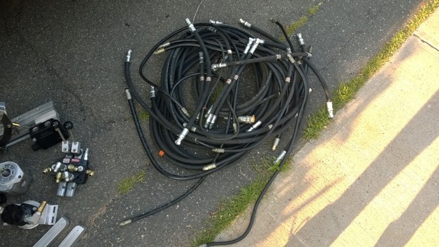

KC9KAS 4,746 #7 Posted August 6, 2015 You really did a great job on rebuilding the tractor and loader. Thanks for the photo's.Did you say you had the set-up to make hydraulic hoses? Maybe you are already listed I the vendors section for replacement hoses! 1 Share this post Link to post Share on other sites

Kelsey 94 #15 Posted August 6, 2015 When I first saw the photo, I thought the WH had a new pivoting hand controller for a steering wheelthen I read the thread. Outstanding renewal job on the tractor! 1 Share this post Link to post Share on other sites

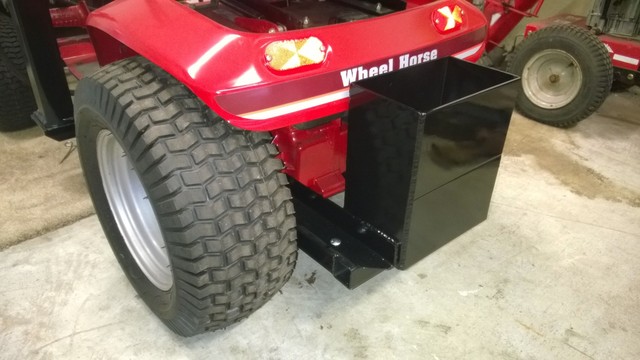

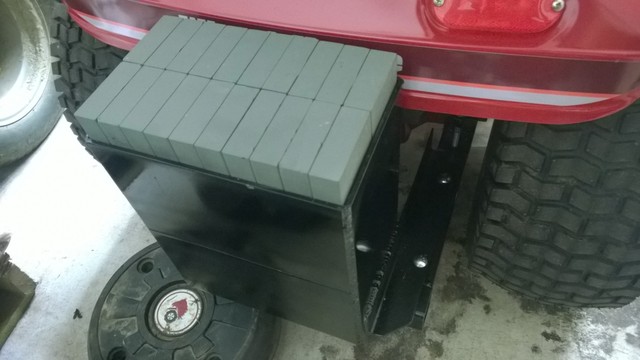

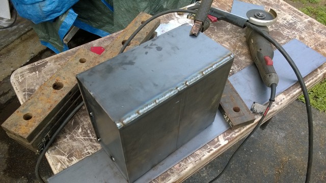

boovuc 1,090 #21 Posted August 7, 2015 That is one of the best saves I've seen. Great job both of you! I love the setup on the PF FEL. (Controls). What's in the weight bucket? Share this post Link to post Share on other sites

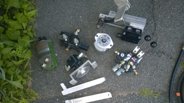

Rexemouse 88 #22 Posted August 7, 2015 (edited) Thanks everyone for the positive feedback!The front tires are 4-ply turfsavers 16x6.5 8. I believe they are factory size for 400 series.I had to have 4 hoses made to get the loader running. I re-used some hoses that I got from my friends dad along with a fresh 6GPM pump and control valve. The deal also included a nice hadex pump, large hydraulic motor, diverter valve, throttling valve with foot pedal, and an aboxious amount of hoses (1/2 JIC). Tuna and I are thinking about using the pump and motor for a loader-mount 2-stage blower for his 420LSE. I have no idea what machine these components were stripped from, but it was definitely something homemade.The weight box uses exercise cable weights. I eventually plan on welding a nice cap to cover the weights. And i did finish tiling... It just took me 2 months because I couldn't keep my mits off the horse. My girlfriend thinks I have a problem. Edited August 7, 2015 by Rexemouse 3 Share this post Link to post Share on other sites
