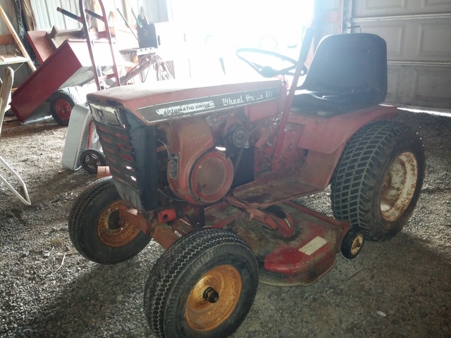

pbmax4910 6 #1 Posted August 4, 2015 Ok I just bought a 1967 877 for my son and I too retore...I have no idea where to start?Any pics or information would be greatly appreciated .,It has the 8 horse kohler and mowing deck runs great still 6 Share this post Link to post Share on other sites

Ed Kennell 47,754 #3 Posted August 5, 2015 TO Print out a manual from the manuals section. Make several copies of the exploded parts drawings. Use these to ID, label, and bag all parts and fasteners. The manual will also show you the parts that may be missing from your tractor. I can see on your photo, you are missing the starter/flywheel belt guard.I just bought a 1965,875 with a broken connecting rod. I replaced the rod and tuned it up and it runs perfect. And that little rear discharge deck really cuts a nice lawn.Best of luck, have fun, and keep us posted .... 3 Share this post Link to post Share on other sites
953 nut 70,078 #4 Posted August 5, 2015 Always glad to hear about a father and son project. The first place to start is to see what you are starting with. Get it running (if it isn't) and see how strong the transmission is. We have lots of restoration threads on this site and plenty of folks that can and will help along the way. Be very methodical when you disassemble and as "kudzu3" said take lots of step by step photos. Download the manual from our Manuals section and label parts as you go along using the numbers and names from the manual. Use storage containers and put labels on them too.Share progress reports and photos as you go along and best wishes. 3 Share this post Link to post Share on other sites

stevasaurus 23,861 #9 Posted August 5, 2015 Welcome to Red Square I don't know what you know about hydros, but if you want to push that horse around at all, you have to open the tow valve. Lift up the seat...it is a 1/2" bolt on the left side down between the pump and the tool box. You only have to open it about 1/2 to 1 turn and then you can push or tow the tractor. Be sure to gently tighten again when you want to ride it...the hydro works better when closed. Don't ask how I know that...I just bought an 876...it is just one year older then yours. You guys will love this horse. 2 Share this post Link to post Share on other sites

pbmax4910 6 #11 Posted August 5, 2015 Good luck on your new 877 if there's anyway I can help you please let me know . tbank you I'm sure I'll need it .the hydro works better when closed. Don't ask how I know that Go ahead ...... ask me how I know that. I already used your advice last night worked like a charm Thanks was wondering what was going on Share this post Link to post Share on other sites
