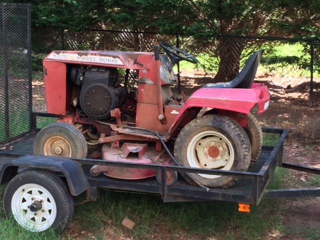

Tuneup 1,459 #1 Posted August 4, 2015 Well, hi all,Wonderful resource here!I'm Marc from Georgia USA. Letting y'all perhaps rejoice in the likelihood that a 1980 black hood will be restored. I've done everything to the house, yard and cars and have time on my hands. An old friend (92) gave me this 125 he had sinking in his yard. Said he rode it there two years ago - not likely. His mind's really clear, otherwise. WWII Lexington - Hellcats. OK, I dragged the poor thing onto a trailer with a come-along. Wanted to get her to run to see if she was worth restoring, although I kinda know this is going to be a labor of love. I grew up with a Simplicity 707 and love the old tractors.So...Pulled the frozen 42" deck which can use a minor weld on top and some bearing refreshing. One of the pulleys ahead of it from the PTO, the return, is frozen...Two rear tubes and she rolls, a coil to solve the open primary, repaired ignition switch, battery, bypassed open ammeter, drained and cleaned tank, repaired fuel pump, pulled a piece of rust from the main jet, filed points - starts! Runs around the yard like a banshee and charges. Starter sounds hellish, though. Sheet metal over the head missing...Front left wheel/tire looks like it's off a Ranger - tall and narrow. Front right looks original.Bad Hi/Lo so pulled the trans and find the Hi/Lo fork separated and rattling. Oil is caramel colored but not so water filled to do damage - good bearings and only some wear on the inner Hi gear. Good news if the parts come in so it's now hurry-up and wait.Had loads of fun pulling those hubs. The first one the puller actually snapped - even with heat - so I'm in the market on that one. Second came off easily enough.I'll put her together and will start on the deck. If I can cut grass, it will be time to tear her apart for a full restoration - something I have never done before - more a mechanic than a restorer.If I do a nice enough job, maybe he'll give me the older one with the 8HP Briggs. There, you have it! I'll be spending plenty of time here gaining knowledge. The youtube vids on trans assembly from Stevesaurus will serve me greatly, thanks! Here's the going-home pic. Right now, she's at the end of the driveway covered and the trans is in pieces on the bench. 5 Share this post Link to post Share on other sites

Wheel-N-It 2,978 #3 Posted August 4, 2015 Welcome from NC. The C125 Blackhood is a relly fine smooth machine when its running properly. You have the shaker plate Kohler. Very very smooth at WOT. And like you, I grew up on an old Simplicity 728. I still have it and another one like it. On your C125 I will suggest replacing the plastic rear fender pan with the later 300 400 500 series metal fender pan. The metal pans bolt right on where the old plastic pan came off. The 1984 Blackhoods came that way from the factory. Share this post Link to post Share on other sites
Tuneup 1,459 #4 Posted August 4, 2015 Yeah lots of work but I'm a sucker for it. Thanks for the welcome! Great to be here.We gave that 707 with its lovely 32" deck and snow blower to a friend. It's probably still in a garage somewhere in Flanders NJ. I took its 7HP Briggs and mounted it on a minibike. Those were the days. She left us with a Tecumseh mounted.Yeah, the fender pan is trashed as is the seat. More shopping 1 Share this post Link to post Share on other sites
