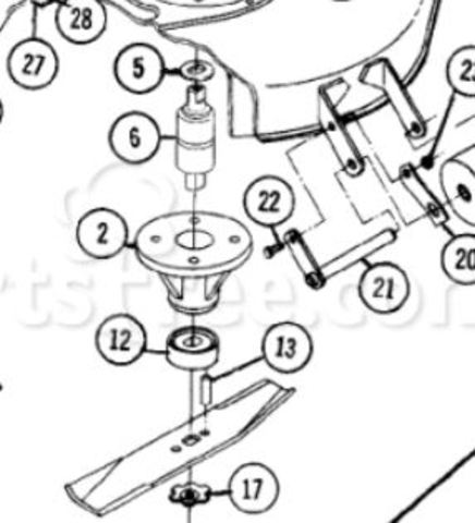

NWSER 0 #1 Posted August 4, 2015 So having a problem rebuilding the center spindle on this B-60 (61-07k801(1976)) model, the deck is a 36" RD with no number tags so i looked up and found that in 76 they made this model 65-36xr01 which looks similar. so apon recieving the aftermarket spindle shaft and bearing assemble #230-078 (OE no longer available) i removed the old assembly and installed everything back to where i found it, the issue I'm having is once back together the whole assembly with ride up and down about an 1/8th inch and there is nothing i can see the i missed nor any holder suck as a snap ring that was missing, is this a common issue with there decks? or am i missing something the diagram isn't showing?Thanks in advance,Eric Share this post Link to post Share on other sites

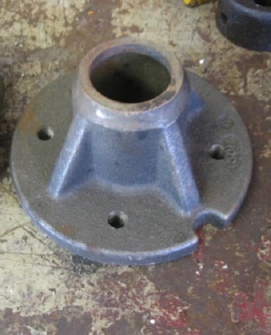

daveoman1966 3,884 #2 Posted August 4, 2015 This is the schematic of 65-36xr01. The bearing # 6 is a tight PRESS FIT into the housing # 2. Apparently your hosing is worn out or badly rusted...disintegrated.There is no fix to that. You'll need a new housing (2) and I have some in my shop. If you want one, send an email to me here (just clik the link:daveoman@windstream.net Share this post Link to post Share on other sites
NWSER 0 #3 Posted August 6, 2015 Daveoman- Thank you for your input i was able to find a spare off a parts deck i had, kept it as an assembly from the other deck so no need to swap parts Share this post Link to post Share on other sites
slammer302 2,157 #4 Posted August 6, 2015 did you remember to put the washer under the pulley? it would be #5 in davomans picture Share this post Link to post Share on other sites
NWSER 0 #5 Posted August 7, 2015 Yes that was one of the first things I checked when I had the play, it wasn't a side to side but an up and down play I had and its the bottom blade adapter that I find holds in in place the spaces keeps it from riding too low and hitting the bolts, when I put the old shaft up to the new aftermarket one it looks like the flat edges they cut into the shaft doesn't go the full amount as the others, believe I measured 15/16" down on both ends on the old one and the new one was 15/16" on the long end and on the short side (top) was on 13/16" possibly even 25/32" and I thought that was the problem but seemed like too much of a hassle and the used assembly I had was in great shape came out nicely. Share this post Link to post Share on other sites
