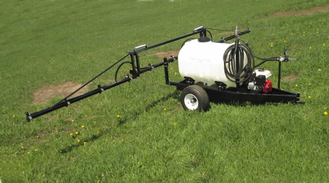

Racinbob 13,112 #3 Posted August 3, 2015 One similar to this? I had a 60 gallon that I used all the time. The tractors you have won't even notice it hooked up. You may want to consider an electric pump. Beats maintaining another motor. 1 Share this post Link to post Share on other sites
doc724 927 #4 Posted August 3, 2015 I considered a pull behind sprayer but instead opted for a 16 gallon unit from Northern Equipment that was designed to mount to an ATV. It has a single nozzle out the back that can spray about 10-14 feet wide (depends on how high you mount it) and you don't have to worry about whacking a horizontal boom on any trees like the one in Racinrob's pix. I made a custom tray to mount to my C141 (quick attach of course) and I can get it on and off in under 3 minutes). After I made my custom tray, I found one at harbor freight (used for carrying beer coolers) that will slip into a receiver hitch if you have one on the tractor. The HF tray cost less than my custom one, but I did not have a receiver hitch. The sprayer works great and it has a separate wand on a 15 foot hose that is useful for attacking the poison ivy which is all over the place here. Share this post Link to post Share on other sites

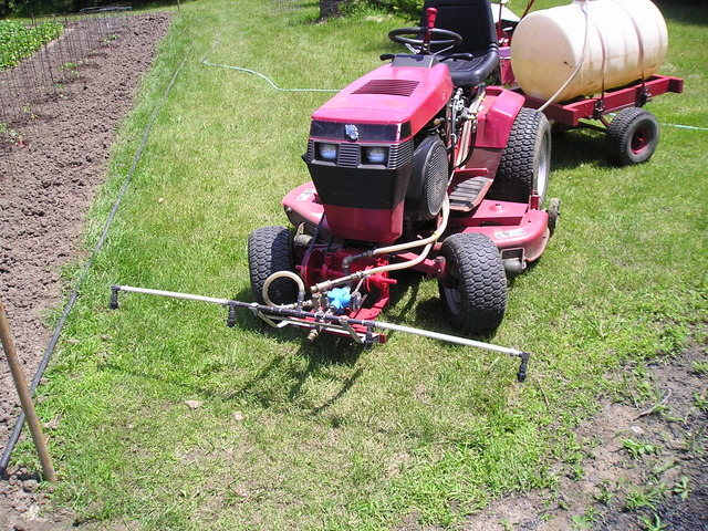

Madcat 9 #5 Posted August 3, 2015 60 gal tank, PTO pump, short spray boom allows easy go through and around trees. 4 Share this post Link to post Share on other sites

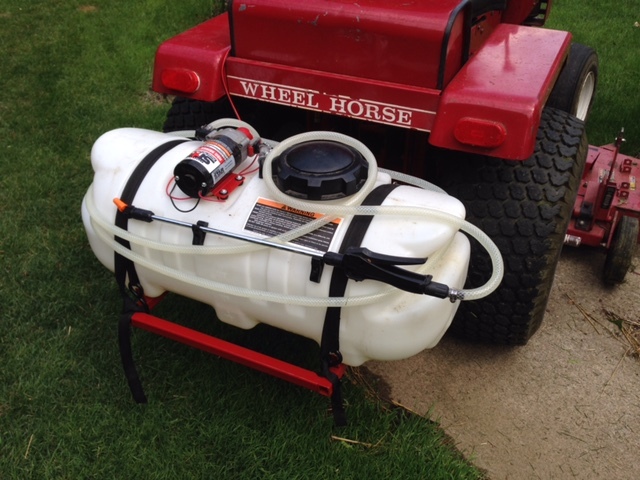

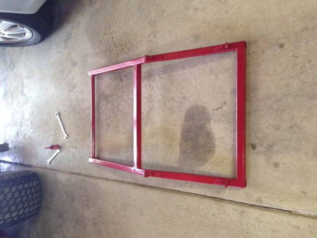

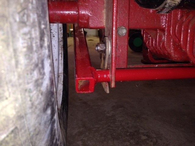

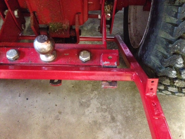

tommyg 157 #8 Posted August 3, 2015 I purchased this Northern 16 gallon sprayer and fabricated this easy on, easy off support that attaches to the rear "Tach-a-matic" bracket on my D-180. Sure beats pulling a trailer. Haven't connected up the electrical yet, but my plan is to wire in a jack similar to a headphone jack on your iPod for the electrical connection. 2 Share this post Link to post Share on other sites
