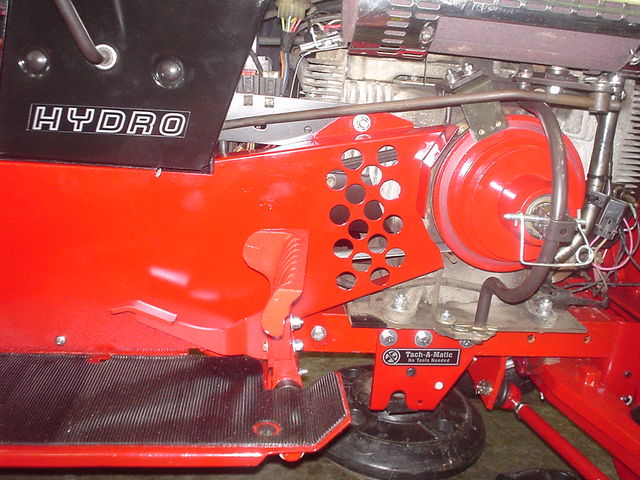

cleat 9,403 #9 Posted July 31, 2015 The hydro is so much better with foot control. Why Wheel Horse stayed with hand controls so long is beyond me.I have Matt's kit on all 3 of my 520's and driving them is nice, the 416 on the other hand with the control just under the steering wheel just does not work as well.Cleat 1 Share this post Link to post Share on other sites

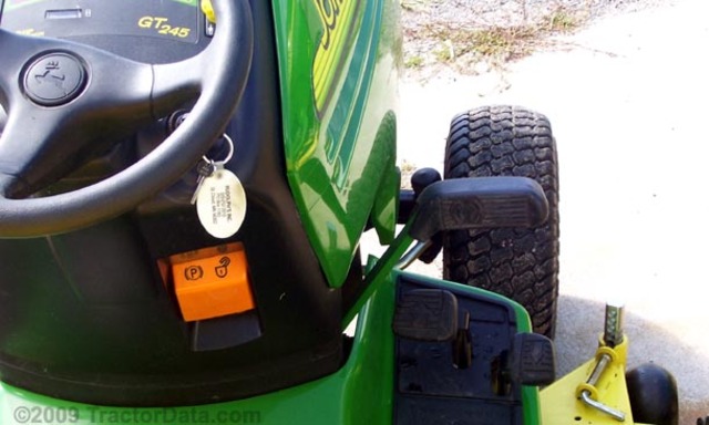

bds1984 1,519 #12 Posted August 2, 2015 I was thinking of eliminating hand controls and go with the 'twin-touch' automattic set-up like my mom's JD GT235 has. I really like the idea of a pedal for each forward and reverse motions.If this comes to pass, I'm looking at using a 42-inch deck to cut grass. I think a 48-inch is a bit much even on an 8-speed. Share this post Link to post Share on other sites

bds1984 1,519 #14 Posted August 2, 2015 Cleat I have only once used the twin-pedal hydro that is a heel-toe set-up and I hated it. My mom's JD has it side-by-side so it feels more going between the brake and gas pedals like driving a car. I know it will take some engineering on my part but it is nothing that I cannot do. Right now I believe the biggest hurdle to clear is the motivation!!!We'll see how cutting the grass goes with the new machine when I get back home tomorrow and install a new ignition switch; the switch was $42! Ouch! Share this post Link to post Share on other sites
cleat 9,403 #15 Posted August 8, 2015 That pedal setup is just like the Cub at work. You will find Matt's kit is kind of similar in that you can use your toe for reverse as well, it will be located a few inches further back is all.This is Matt's kit on one of my 520's.Cleat Share this post Link to post Share on other sites
