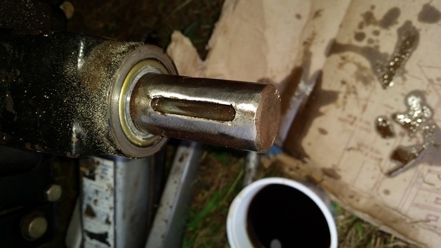

Xearl 132 #1 Posted July 30, 2015 (edited) I have a 518XI that I am going to sell but the keyway on one axle is enlarged because the set screws were not kept tight. Does any one have any suggestions , I really don't want to remove the axle . How about epoxy steel . ???? Edited July 31, 2015 by Xearl Share this post Link to post Share on other sites
boovuc 1,090 #2 Posted July 31, 2015 If you don't want to take the tranny apart, I would talk to a machine shop about what they suggest doing. With cooling on the axle running away from the hub, the keyway could be cleaned up and a "special fit" key could be made to fit it. Make sure the set screws a properly cupped before putting it back together. That should have two setscrews. Was the axle seal leaking? Share this post Link to post Share on other sites
Xearl 132 #3 Posted July 31, 2015 Yes the seal is leaking but the axle and hub are OK . The keyway is sloppy from the wheel being loose . I found a product that claims to repair damage to keyways ( Belzona 1111 ) but it only comes in larger amounts and would be over $200 . I was wondering if a product like liquid steel ,an epoxy , would work . They claim it can be drilled and tapped . I also found someone who made a brass key ,held it in place , and welded around it . The weld did not stick to the brass and he was able to clean up the weld . It worked. I was wondering if you knew where I could get a seal. Thanks for the input . Xearl Saugerties,NY Share this post Link to post Share on other sites

Xearl 132 #8 Posted September 10, 2015 My repair . From the forum someone welded the key way by making a brass key and welding next to it . I did the same a friends son runs a welding shop and he tig welded it for me .The edges look a little rough but the key fits snug . I replaced the seal and I have a new hub. 8 Share this post Link to post Share on other sites
