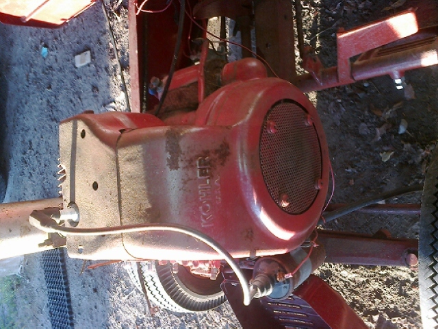

Rob.A.700 306 #7 Posted July 28, 2015 (edited) I forgot to mention before thanks for the add! As for the serial number plate that is gone as well. The motor does appear to have been swapped out to a kohler k181s with a 12v ignition system. However I must admit I do like the little stack the previous owner put on. Edited July 28, 2015 by Rob.A.700 3 Share this post Link to post Share on other sites

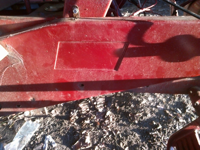

Rob.A.700 306 #11 Posted July 29, 2015 Is there any serial numbers stamped into the frame other then the tags? I am thinking it could possibly be a 855 or 856 because there is an indent on the tin of the belt guard. Does any one know if that square indent only came on the 855 or 856s? Share this post Link to post Share on other sites

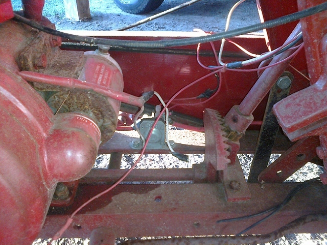

octfst 378 #12 Posted July 29, 2015 There's no numbers in the frame. only on your missing tag. I think your right about indent in the belt guard as far as 1965 & 1966 models. but if it's not the original motor could have been a tecky 6hp like a 606. No mater what I would leave the K 181 on it and it will make you a good tractor. lots of tecky powered tractors got repowered. If it's K181 it would have a starter generator on it and I didn't see one in your pics there should be numbers on your motor that could help you there. Share this post Link to post Share on other sites

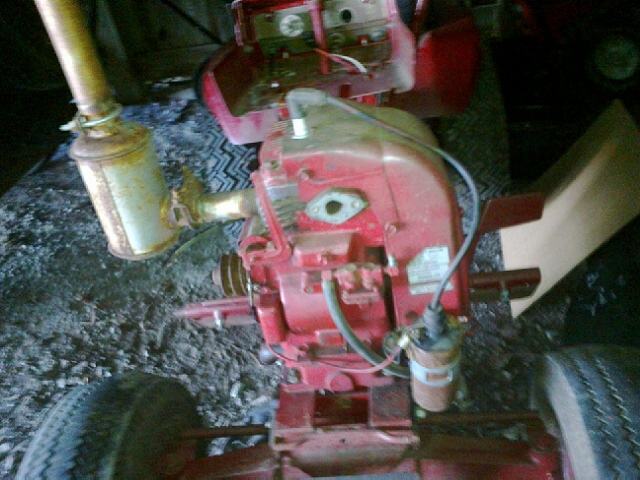

Rob.A.700 306 #13 Posted July 30, 2015 The info tags were still on the motor so I was able to determine that it is a 74. So I believe that it has been re-powered and that it may very well be a 606. Although with out the tags I will never know for certain I am alot closer than I was before thanks for everyone's help. Share this post Link to post Share on other sites

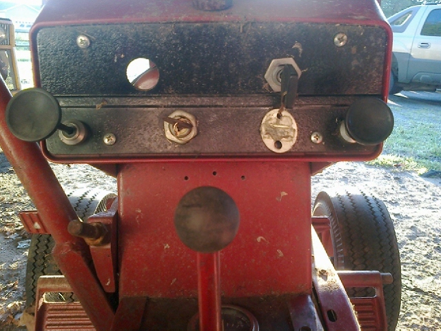

gwest_ca-(File Mod) 10,441 #14 Posted July 30, 2015 You did look at the very top of the panel below the dash housing for the ID plate? You almost have to get down and look up to see them.Garry Share this post Link to post Share on other sites

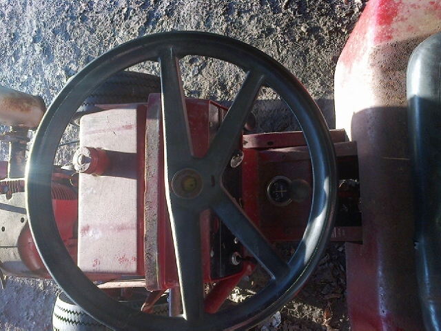

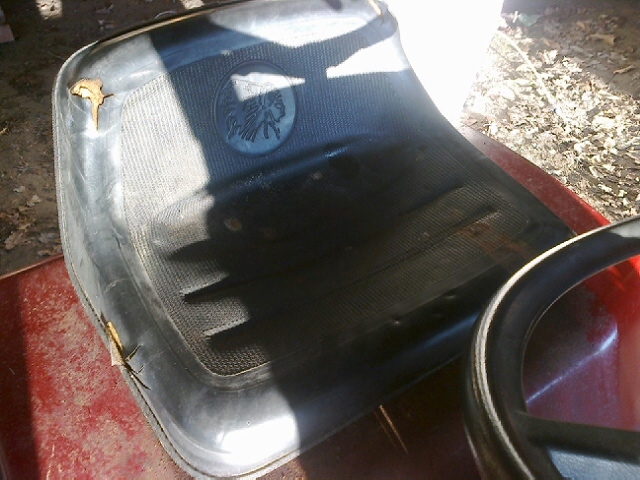

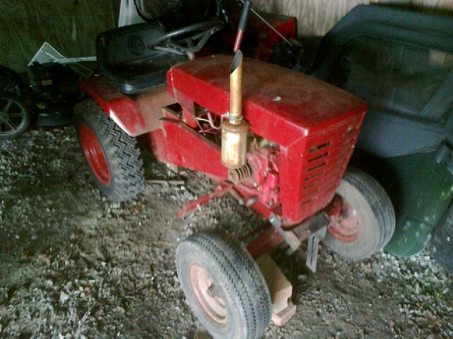

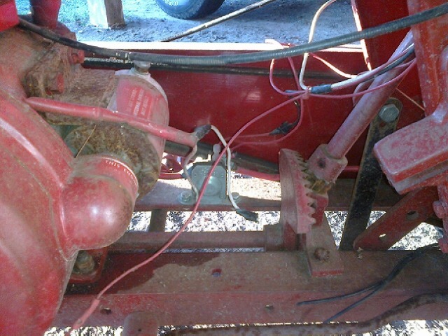

Rob.A.700 306 #16 Posted July 31, 2015 Here are a few more photos. See what you think... The dash pic shows the holes where the serial number tag was. The square indent on the belt guard. The seat. The trans with the corner of a tag left. The motor witch I identified as being a 74. The nice little wiring set up. The steering wheel wich i believe was also swapped out also you can see the ampmeter someone installed Share this post Link to post Share on other sites

AMC RULES 36,935 #19 Posted July 31, 2015 Never have seen that big chief, Indian head seat before. Share this post Link to post Share on other sites
CasualObserver 3,406 #20 Posted July 31, 2015 Never have seen that big chief, Indian head seat before. It's from a Lawn Chief lawn mower... hardware/farm store kind of brand. 1 Share this post Link to post Share on other sites
AMC RULES 36,935 #21 Posted July 31, 2015 The perfect seat then... for your Techy powered machine. Share this post Link to post Share on other sites

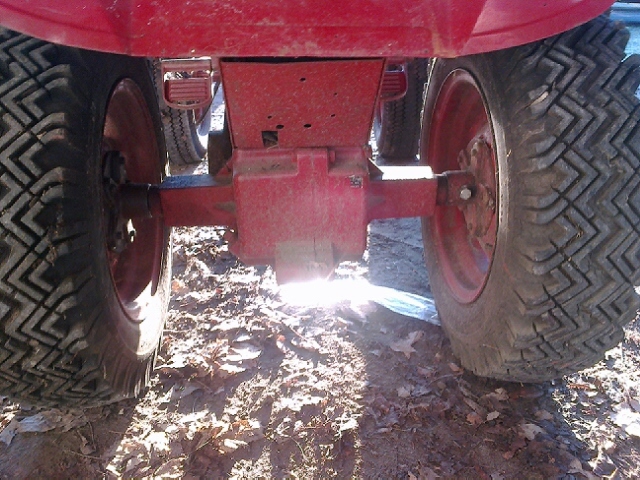

CasualObserver 3,406 #22 Posted July 31, 2015 Many of these models are hard to nail down totally without a ID tag. Sometimes a tag doesn't even matter, because so many parts are interchangeable that machines have just been cobbled together to get something that runs and works. Without complete records from an original owner, you can never know for certain. From your pictures....most likely originally a 65-67 Tecumseh powered machine, meaning 605 / 655 / 606 / 656 / 607 / 657. Clues... the squared off gas tank which would have originally been mounted to the engine the 6-12 rear tires and skinny front tires (Kohler 8HP machines all came standard with 23x8.50-12 rears and wider front tires) Rear fender pan is skinny size (wider pan started in 1968) More likely to be 65-66 than 67 due to the belt guard indent, but in my opinion not definite. I seem to recall discussion way in the past about early runs of 1967 using up the supplies of already stamped belt guards before they changed the tooling to eliminate the indent. I can't locate a picture at the moment to back it up, but regardless, like anything Wheel Horse, there were subtle small changes constantly through production. Take that for what you will.... YMMV (your mileage may vary) 2 Share this post Link to post Share on other sites
