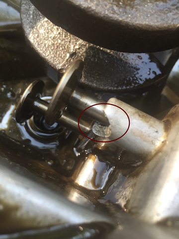

WNYPCRepair 1,924 #1 Posted July 27, 2015 I decided to give rebuilding the engine from my pressure washer that I loaned to my friend. It had the broken connecting rod. After I took the crankcase apart, I saw the chunk broken off inside. Is it even worth messing with at this point? Share this post Link to post Share on other sites

squonk 48,138 #4 Posted July 27, 2015 A friend of mine repairs these all the time on B @ S racing Go Kart motors. He could probably fix that. but is it worth it or just buy another pressure washer? 2 Share this post Link to post Share on other sites
WNYPCRepair 1,924 #5 Posted July 27, 2015 A friend of mine repairs these all the time on B @ S racing Go Kart motors. He could probably fix that. but is it worth it or just buy another pressure washer? Yeah, it appears B&S may let me return the parts, so probably not. I could buy another block, but the cost of the parts and the block is as much as a new power washer Share this post Link to post Share on other sites
