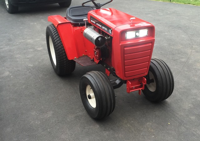

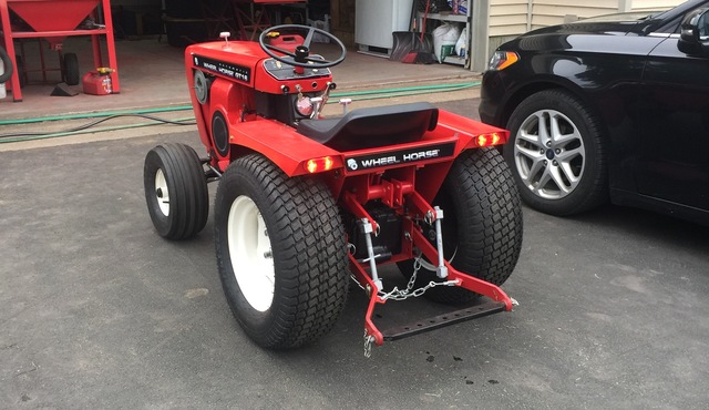

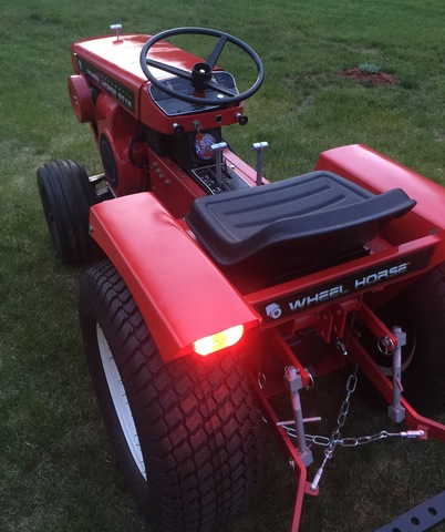

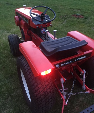

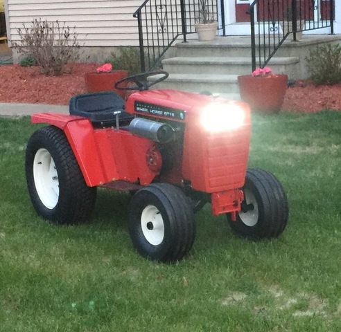

Aldon 4,832 #211 Posted May 22, 2016 Since I was troubleshooting at dusk, why not get a couple pics with lights....note you can see the dual fuel/voltage gage lit up as well. 8 Share this post Link to post Share on other sites
ztnoo 2,302 #212 Posted May 22, 2016 (edited) Aldon, Looking good. How's the db level with that gold plated Toro muffler compared with Lazarus??? Edited May 22, 2016 by ztnoo 1 Share this post Link to post Share on other sites
953 nut 67,529 #213 Posted May 22, 2016 1 hour ago, Aldon said: tow valve I didn't mention that because I was sure you would have closed it! I guess the excitement could get to anyone. 1 Share this post Link to post Share on other sites
Aldon 4,832 #214 Posted May 22, 2016 1 minute ago, 953 nut said: I didn't mention that because I was sure you would have closed it! I guess the excitement could get to anyone. I was actually very keyed up as I had just finished the marathon wiring and initial build. Missing the tow valve is a rookie mistake but I feel a little better as it truly is out of site and out of mind with the 3 point hardware blocking it. It was actually a bear to turn it..... @ztnoo , the muffler is noticeably quieter. And the motor is 2 additional HP. Not sure it's worth another 180 over the pepper pots but I would likley but it again if it ever fails and it's available. Truth is my decks are louder than my tractors:-) i know. Rebuilding decks is next up on project lists.....then sickle bar and then a Rototiller refresh....I need more vacations. Lol 4 Share this post Link to post Share on other sites

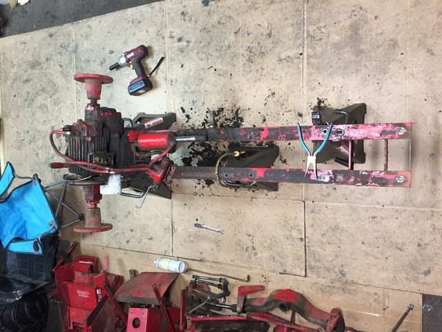

BigRedGrizzly 229 #215 Posted June 16, 2016 On May 21, 2016 at 9:43 PM, Aldon said: I was actually very keyed up as I had just finished the marathon wiring and initial build. Missing the tow valve is a rookie mistake but I feel a little better as it truly is out of site and out of mind with the 3 point hardware blocking it. It was actually a bear to turn it..... @ztnoo , the muffler is noticeably quieter. And the motor is 2 additional HP. Not sure it's worth another 180 over the pepper pots but I would likley but it again if it ever fails and it's available. Truth is my decks are louder than my tractors:-) i know. Rebuilding decks is next up on project lists.....then sickle bar and then a Rototiller refresh....I need more vacations. Lol Hi Aldon...I'm in the process of a restoration on my 1970 GT14 and I wanted to use the stainless steel nuts and bolts as you did. In an effort to save time and frustration I was wondering if you happen to have the quantity and sizing of the hardware you purchased. I was hoping you had a list something. Also.. I'm having a really hard time pulling my steering wheel. I didn't notice a roll pin in there. But the whole is filled with crud. Could it be an Allen key? Thanks in advance. 2 Share this post Link to post Share on other sites
Aldon 4,832 #216 Posted June 16, 2016 1 hour ago, BigRedGrizzly said: Hi Aldon...I'm in the process of a restoration on my 1970 GT14 and I wanted to use the stainless steel nuts and bolts as you did. In an effort to save time and frustration I was wondering if you happen to have the quantity and sizing of the hardware you purchased. I was hoping you had a list something. Also.. I'm having a really hard time pulling my steering wheel. I didn't notice a roll pin in there. But the whole is filled with crud. Could it be an Allen key? Thanks in advance. BRG, Getting the tear down to the point in your pic is a huge accomplishment so it looks like your well on your way to getting yours restored. I utelized Stainless in a few places but mostly I used yellow zinc grade 8 hardware that I bought in bulk at Tractor Supply. I knew that was the plan going in so I did not develop a list. although if I restore my other GT14, I may go the route of Stainless and have a professional do the body and paint. As for your steeing wheel, I have pulled several. They all had roll pins. That does not necessarily negate possibility of an allen key, but I really would bet against it. An allen key would require the receiving side to be female threaded. I think the odds of this to be low. Once you get pin out, the wheel may still fight being pulled off. 50 years of crud, rust and corrosion can create a significant bond. Also, I have had instances where the roll pin diameter allowed me to insert a allen wrench and it felt as if it was an allen key as the allen wrench fit just right in the opening of the roll pin and I got some resistive tension. Good lighting and degreaser is a time saver for sure. 3 Share this post Link to post Share on other sites

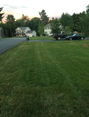

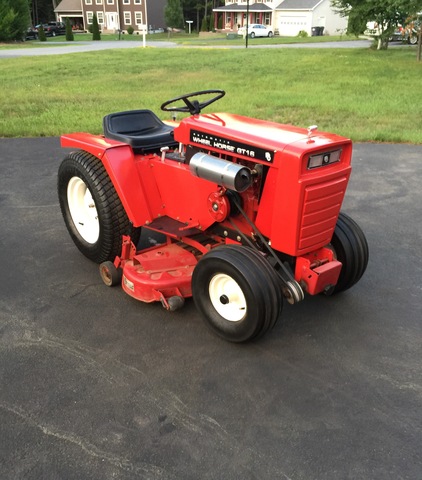

Aldon 4,832 #217 Posted June 30, 2016 Some I spoke with at the show seemed surprised that I planned to work this beast when I brought "Elijah" back from PA. At the show I pulled the 3 point lift bar and loaned it to a vendor for a template since I had a spare at home. I DO NOT SUGGEST anyone try the same. It's a bear to get it out. Exponentially more difficult installing it with most of the tractor intact. But I finally managed that and got the temporary 42" deck from Lazarus installed. I am in last stages of restoring both a 48 inch deck and an Ariens/C-195 deck which will be the primary decks for Elijah once finished. Then I'll complete the Tiller and Sickle Bar as well. pic of deck mounted and the resulting cut.... 5 Share this post Link to post Share on other sites

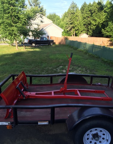

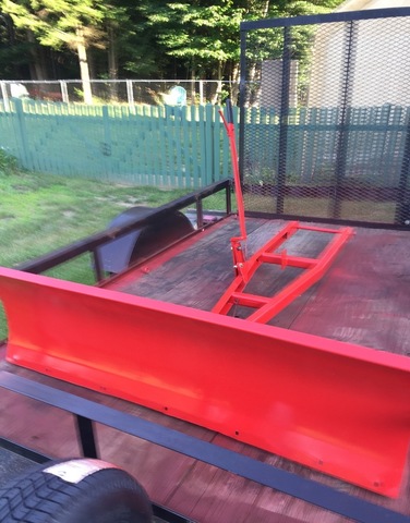

Aldon 4,832 #221 Posted July 11, 2016 Starting to tackle the implements. Assembled the 54 inch Dozer blade today. my iPhone is acting up so pardon pic quality. 4 Share this post Link to post Share on other sites

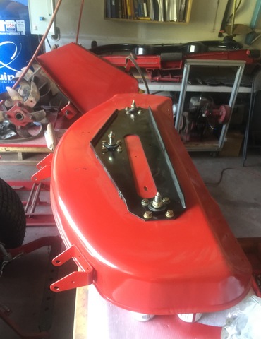

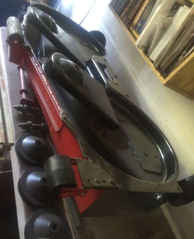

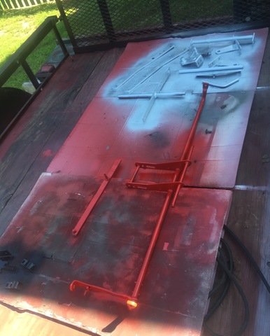

Aldon 4,832 #223 Posted August 20, 2016 Figured it had been too long without an update of some type. I am working on several implements but this update is for the two additional decks I plan to use on Elijah and Lazarus. I currently am using a new old stock 42 inch read discharge which does a good job, but bigger may be better. In search of the perfect deck for my modernized GT14's I am in the process of rebuilding a 48 inch deck with the more modern spindles etc and I snagged a 60 inch Ariens C195 deck from Stevebo which has all new bearings etc. both are basically in the assembly process. You can see from the dust that the C195 deck has been waiting 4-6 weeks for temps to lower to point my motivation returned. I made some headway today. 5 Share this post Link to post Share on other sites
PeacemakerJack 11,022 #224 Posted August 21, 2016 Aldon, that is looking great! I can't wait to see how that all looks once it is complete. I'm interested to see how that big 60 looks on the GT-14. You do awesome work my friend and I'll be following to the finish! Zach is too! 2 Share this post Link to post Share on other sites
