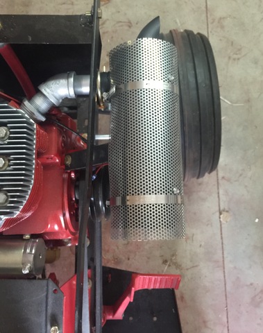

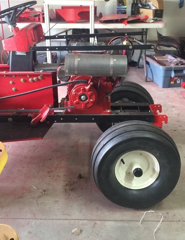

Aldon 4,832 #177 Posted May 16, 2016 It's actually too cool outside to work with paint. In late May! Crazy. Anyway, I took the opportunity to finish the muffler set up. I had ordered perforated stainless off fleabay and it fortuitously cam in while I am sitting on my thumbs doing shop clean up etc. I don't really have an easy way to trim it so I ordered size that was close to what ideally I thought I'd need. I figured it would be 1/2 inch too long and it is. But I can live with it since it's a worker....or will be after the show. The piece I ordered was 12 X 12. I used 5 inch stainless clamps to keep the shape and snug it up against the tabs or stops on the muffler and a couple stainless sheet metal screws through the perforation into two of the tabs to keep the set up from sliding around. The decals arrived from Terry. They look AWESOME! Can't wait to get this thing assembled. 2 Share this post Link to post Share on other sites
953 nut 67,529 #178 Posted May 16, 2016 12 minutes ago, Aldon said: don't really have an easy way to trim it I used a cut off wheel on a 4" grinder, zipped right through. 2 Share this post Link to post Share on other sites
Racinbob 13,047 #179 Posted May 16, 2016 Looking great and I love those decals. 1 Share this post Link to post Share on other sites
Aldon 4,832 #181 Posted May 16, 2016 2 hours ago, 953 nut said: I used a cut off wheel on a 4" grinder, zipped right through. I did consider that method. May do so if time allows to tweak. When you did so, did the stainless discolor from the heat caused by the cut-off disc? Share this post Link to post Share on other sites
953 nut 67,529 #182 Posted May 16, 2016 57 minutes ago, Aldon said: did the stainless discolor from the heat The edge did a little, but when I filed it smooth the blue went away. 1 Share this post Link to post Share on other sites

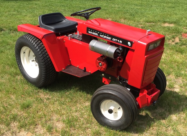

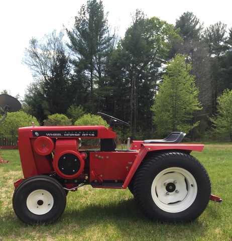

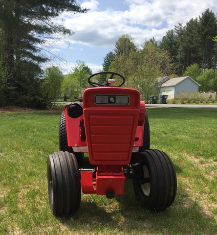

Aldon 4,832 #183 Posted May 17, 2016 (edited) Well I finally ran out of time to make paint perfect. I only have a few days vacation left before life gets very hectic again. So there are a few runs in the paint but for my first actual build and since it will be put to work very soon, it's good enough for a garden tractor:-) As such things are moving at a quicker clip now. Edited May 17, 2016 by Aldon 4 Share this post Link to post Share on other sites

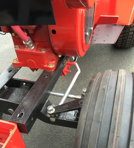

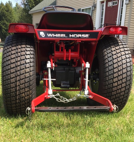

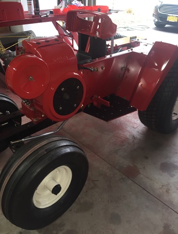

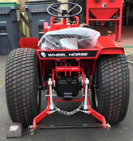

Aldon 4,832 #185 Posted May 18, 2016 Realized today as I was installing mid mount attach-a-matic mounts that I had installed the fan gear to spindle tie Rod upside down or reversed. Switched it back. The design of this tie Rod does not match the one on Lazarus. And this tie Rod impacts with mid mount hardware and limits turn radius. Gonna leave it for now but may have a new one made up later using Lazarus' as template. Seat is installed and rear panel and decal. Starting to look like a tractor again. Rain is on forecast for tomorrow but hopefully I can do wiring and tackle some additional assembly. The countdown is ticking down to Monday when I have to start earning a living again. 6 Share this post Link to post Share on other sites

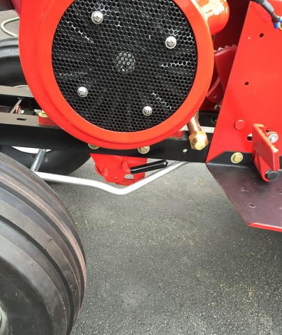

Aldon 4,832 #189 Posted May 20, 2016 (edited) Journey is almost complete. Mechanically it's almost complete except for some rework like with the one Tie Rod and minor putty rework where stresses from deformation in welding caused cracking. Fuel system is plumbed and primed Just need to finish the wiring. So so barrung a mechanical failure during startup, this beast should make the show.... FOR SOME REASON I AM CURRENTLY LIMITED ON UPLOADING PICS. Will upload once resolved. Edited May 20, 2016 by Aldon 2 Share this post Link to post Share on other sites

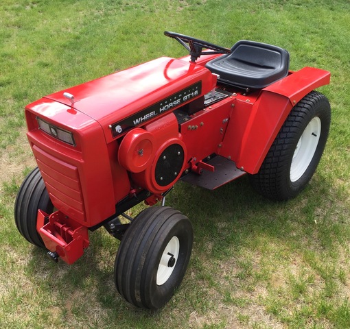

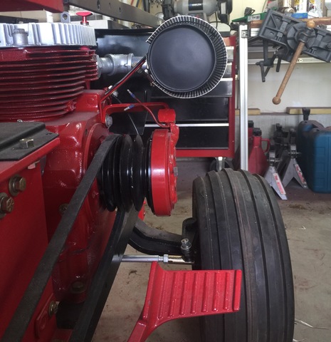

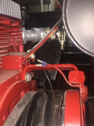

Aldon 4,832 #190 Posted May 20, 2016 (edited) Still something weird with loading pics but I was able to get these loaded. Now back to wiring:-) Edited May 20, 2016 by Aldon 8 Share this post Link to post Share on other sites
