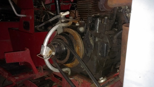

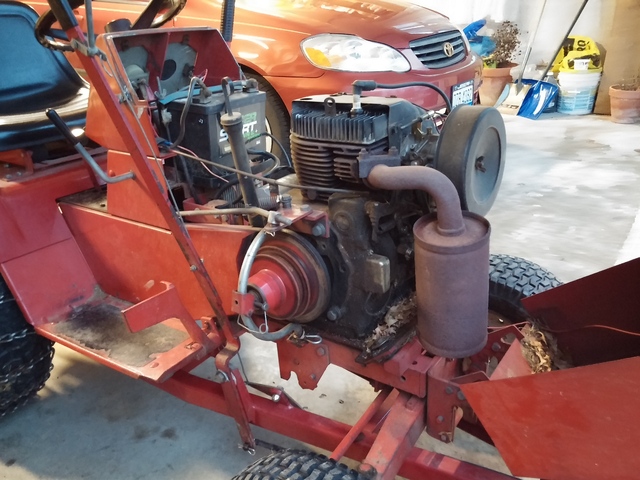

bmsgaffer 2,071 #8 Posted July 27, 2015 C-121? Your engine is mounted on a shaker plate, correct? That mount will not look like MikeRJ's as his is a solid mount.Sorry I dont have great pictures, but here are two that may help. (Be sure to click through to "Full Size" as they are BIG pictures, you should be able to zoom in a good bit) Share this post Link to post Share on other sites
rracioppi 2 #9 Posted July 27, 2015 OK, thanks for the pictures, I think I see what is wrong the pin goes above not below?? What is that pin doing except stopping the bar from going down. Share this post Link to post Share on other sites
bmsgaffer 2,071 #10 Posted July 27, 2015 At the bottom? That pin just stops the bar from going down. If you pull the pin, you can slide the hoop down and out to remove the pto belt. Although, you dont HAVE to take the hoop off to change the belt... I think its just an easy way to remove it. Share this post Link to post Share on other sites
