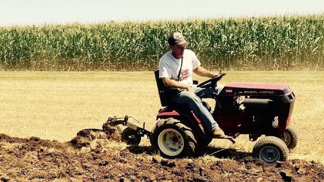

PeacemakerJack 11,080 #36 Posted August 2, 2015 I got about an hour of seat time on my 314 today! It was a lot of fun plowing with that old dude! There are some things that I will have to still upgrade to make it a great plow tractor but I put it through a real workout and overall--I'm impressed. Thanks for encouraging me to buy it.First, I need to install the new belt. It was good plowing in first gear but the ground was pretty dry, hence tough, since we haven't seen measurable rain here in awhile. So in second, it was plowing like a dream for about 250 feet when the belt started to chirp, then squeal, then burn! About the time I put in the clutch it was starting to smoke. Time to go back to first!!! In first gear, she plowed tough and worked hard!!Second, I'm gonna need some weights for the front end! This thing at times was like a bucking bronco!!!! In all fairness to "the Horse", I was pulling my 12" Brinly that I lovingly call "the Punisher"! What do you guys suggest for weight? I know that WH has front wheel weights. Are those a good choice or would I be better to fabricate a front bracket and run weight on it?all in all a super fun day, playing in the dirt! Share this post Link to post Share on other sites
PeacemakerJack 11,080 #37 Posted August 2, 2015 Here is a Video that my buddy took of me plowing today!https://www.youtube.com/watch?v=lwE592s-tDwI guess I don't know how to insert the video like bmsgaffer did. Hopefully you will be able to click the link and watch it. 2 Share this post Link to post Share on other sites

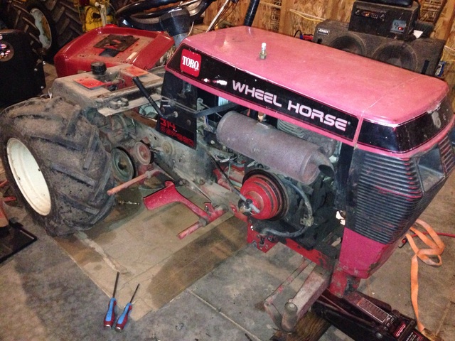

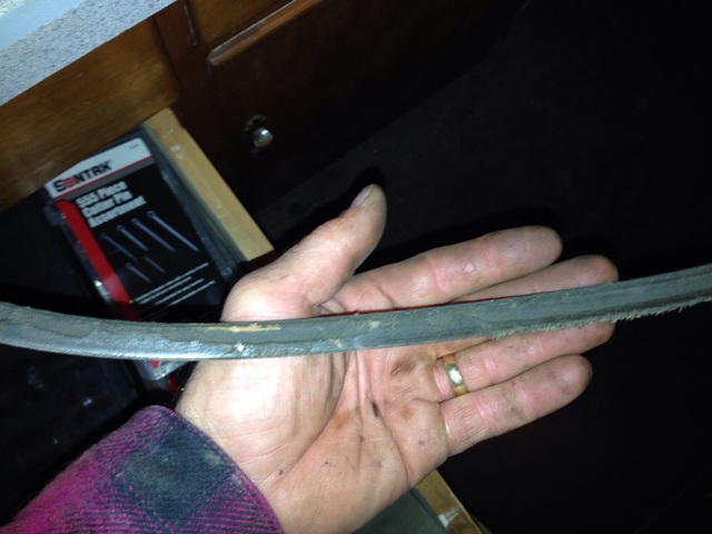

PeacemakerJack 11,080 #38 Posted October 7, 2015 I finally installed my new primary drive belt tonight in preparation for the big plow day this weekend. The old belt was in really rough shape. If I was a betting man, I'd wager that it had never been replaced. I'm eager to see the difference that it will make for getting all that Kohler lugging power to the ground...trying to to get all these last minute things taken care of before the weekend!question: could you guys tell me where the fuel filter is normally located on one of these dudes? I traced the fuel line from the tank to the pump and can't find anything. I could just pick a spot but I figure the factory figured on the best location for a reason! Next up, rear light and front AG's! Share this post Link to post Share on other sites

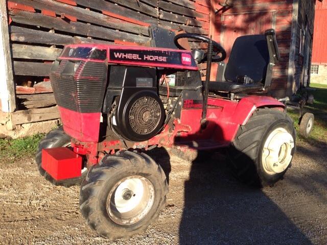

PeacemakerJack 11,080 #42 Posted October 8, 2015 Thanks guys for the information. That is a suprise that they didn't include a filter from the factory. I too try to make sure that I always use good, fresh, uncontaminated fuel. However, in a day and age where nearly everything with an engine on it has a fuel filter, I must admit that I find it interesting that they didn't ship those out with one. Thanks again for weighing in on the subject. Rear plow light is hooked up and front AG's going on this afternoon! I desperately need front weights on this little guy to keep the front wheels on the ground while pulling hard, do you guys have any pictures of rigs with a front weight bracket fabbed for these? Share this post Link to post Share on other sites

PeacemakerJack 11,080 #48 Posted October 9, 2015 Wow! Thanks everyone for weighing in, some great thoughts all around. I don't have time to install a filter before Saturday's plow day because of everything I have yet to do but I'll definitely put that high on my prioritylist. I'm planning to go to a plow day in Buck Creek, IA a week from Saturday and I'll make sure that I have it completed by then. I can't wait to post a couple of pics with the new AG's on the front! This thing really has a tough look set up this way. About the video link above with the plow...I took that plow in on a trade about a year and a half ago. It is a 12" Brinly vs the typical 10". We had several 10" Brinley's in the family but this was the first sleeve hitch 12" Brinly. It is so much larger than a 10" that it is hard to believe. It takes quite a bit more power to pull especially in tough ground. It is moving so much "real estate" that it can man handle a garden tractor pretty easy given the right conditions. It can "punish" an unsuspecting tractor and bring it to its knees, therefore I named it, "the Punisher" after the comic book character. The skull sticker on the back side of the mold board is the Punisher logo! The 314 really handles it well though!Im working on a front frame weight that will add over 60lbs. Hopefully that will be enough to keep meplanted. If not--I'll add more!Hopefully with more weight, my steering gear will take less of a beating! Time me will tell, but I'm looking forward to getting this thing just the way I want it for serious plowing! 2 Share this post Link to post Share on other sites

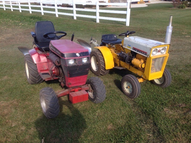

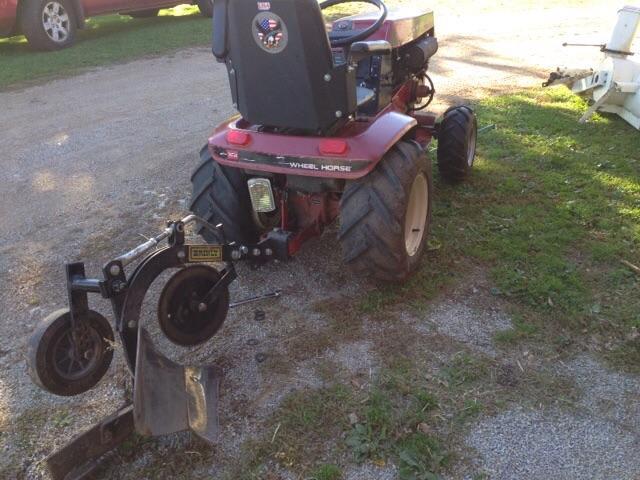

PeacemakerJack 11,080 #49 Posted October 10, 2015 The 314 is ready for serious plowing! Here it is with the Punisher in tow...Thanks to my Uncle Roger who fabbed the weight bracket for the front--adding a quick release 60#! Boy did that make a difference and it comes off in two seconds. Ready for Heritage Plow Day tomorrow! Share this post Link to post Share on other sites

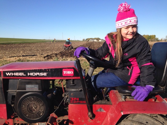

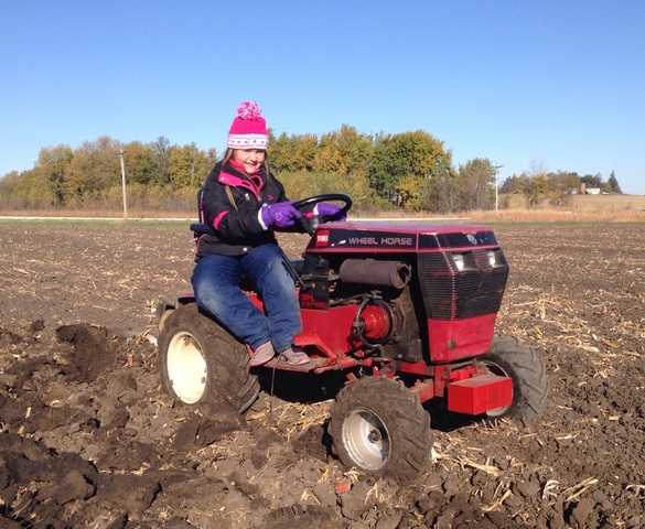

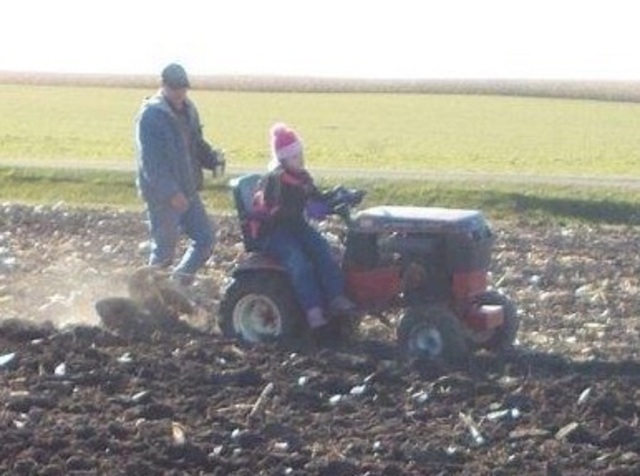

PeacemakerJack 11,080 #50 Posted October 19, 2015 It's OFFICIAL--I like this tractor for plowing!!! I drove 230 miles to attend a Plow Day in Iowa this weekend and took the 314 and my Cub 100. The 314 did a great job with the new belt and fresh weights! The coolest thing about the weekend was taking my son and daughter with me. She is only 8 years old but she begged me to go along and then begged me to let her plow. The 314-8 isn't exactly the most "kid friendly" tractor with manual lift and GD tranny. However, I seized the opportunity and let her have "my" seat! She loved it!We were plowing a field that was nearly a quarter mile long and so I would sit half on the seat and half on the fender to get her started in the furrow, then I would jump off and let her at it.She took to it really quickly and kept wanting to plow another round!My good buddy took this pic from across the field. I'm pretty sure I walked several miles behind her sucking dirt but I couldn't have been happier!I did get some seat time at the end of the day when the kids were worn out but I was happy to have them plowing with me for sure. I let a couple of guys drive the Horse who had never plowed with one before and they were impressed. They kept asking me why there aren't more at plow days...time to to bring them out, Horsemen! No one from the forum showed up at my plow day either. Lots of Cubs, lots of Cases, some JD's but I had the only to WH's at my Heritage Plow Day. These tractors do plow excellent and they are fun to play with. Thanks to all who encouraged me to buy this one--a good decision!!! 2 Share this post Link to post Share on other sites
