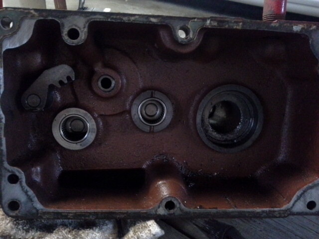

Rosco 11 #26 Posted October 31, 2015 (edited) the parking pawl looks great I suck at taking picture still trying to find bearings Edited October 31, 2015 by Rosco Share this post Link to post Share on other sites
Rosco 11 #27 Posted November 1, 2015 Parking brake looks good still trying to find bearings 1 Share this post Link to post Share on other sites

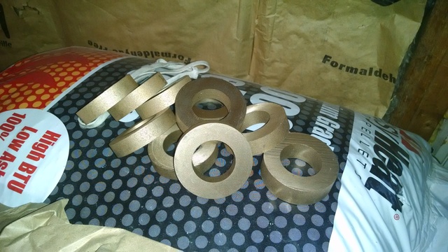

Rosco 11 #30 Posted November 12, 2015 Has any tried oil impregnated bronz bushings Instead of the 1533 bearing ??? I will take the other side of the trains off this weekend. I will let you all know if the bushing works out. Share this post Link to post Share on other sites
stevasaurus 23,861 #31 Posted November 12, 2015 Did you ever try to contact Mike (racinfool40) for the #1533 bearings??? If you are going to try bronze, we want pictures and information. 1 Share this post Link to post Share on other sites
Rosco 11 #32 Posted November 12, 2015 I am going to try the oil impregnated bronze bushings if this works I'll let you know I have plenty extra I had to buy a six inch piece and then cut half inch slugs off of it will send pics 1 Share this post Link to post Share on other sites
stevasaurus 23,861 #33 Posted November 12, 2015 I suppose oil can get to the outer axle bearings through the differential along the axle, but will it be enough?? Share this post Link to post Share on other sites
Rosco 11 #34 Posted November 12, 2015 I'm thinking about cutting a groove in the bushing for oil some of the experts I talked to said I wouldn't need to because this is an oil impregnated bushing You're talking about the outer needle bearings good point back to the drawing board Share this post Link to post Share on other sites
stevasaurus 23,861 #35 Posted November 12, 2015 Not so fast. The #5003 and #5010 transmissions used bronze sleeves in those transmissions for both the differential carriage and the outer axles. There must have been just enough clearance (slop) to let oil seep through. It was not the best design, but it did work and oil got to the outer sleeve. It might be enough to just pack the outer needle bearings with grease and call it good...you may want to do that anyway. Maybe some small holes drilled in these bearings you are making will do it. To test my transmissions that I work on...I put the trans on a table and I have a 1/3 hsp electric motor that I clamp to one end. Put on a fan belt and plug it in. You want the trans input pulley to run counter-clockwise. This saves a lot of time doing something like you are...rather then mounting the trans on and off the horse. I'm not sure how good this is either, but I think it will work for horses that are used for shows, and hauling grand kids around for sure. Is it good enough for workers??? I think it is worth taking a good look. Share this post Link to post Share on other sites
953 nut 70,056 #36 Posted November 12, 2015 If this works out as well as you expect you could become a Vendor here. I know that the 10 W 30 in a hydro will splash around pretty good, not too sure a manual transaxel would do so well unless you went to the 40 weight motor oil called for in the older owner manuals. Share this post Link to post Share on other sites
