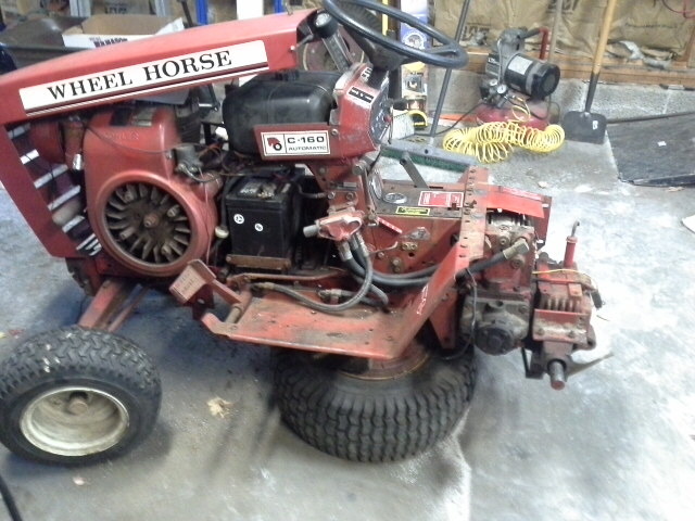

Rosco 11 #18 Posted October 27, 2015 First pic I ever took with the tablet can't figure out how to attach it mybe the file is to big Share this post Link to post Share on other sites
Rosco 11 #19 Posted October 27, 2015 Maybe with a little paint it might look like something 3 Share this post Link to post Share on other sites
stevasaurus 23,861 #20 Posted October 27, 2015 If you try to change out those bearings with out taking that trans off the frame...I hope you would share a ton of pictures. 1 Share this post Link to post Share on other sites

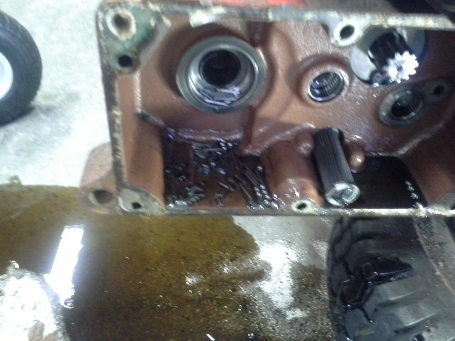

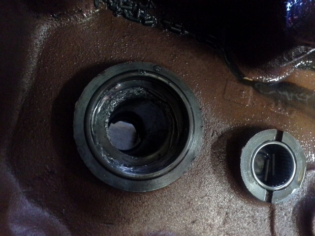

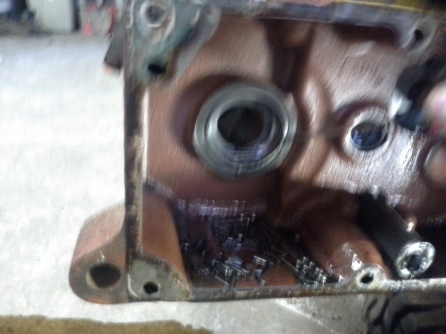

Rosco 11 #21 Posted October 31, 2015 I split the trans with it still on the frame the inner bearings were destroyed any know were i can find the inner bearings the wheel horse # 1533I will send pic Share this post Link to post Share on other sites

Rosco 11 #24 Posted October 31, 2015 (edited) the pics Edited October 31, 2015 by Rosco pics Share this post Link to post Share on other sites
pfrederi 21,274 #25 Posted October 31, 2015 That doesn't look good. Sorry. What does the parking pawl look like I do not see it in the picture.That much damage I think you should probably go ahead on look inside the hydro motor and pump. There is strong likelyhood that a lot of the metal bits got through the suction screen (it only gets the big chunks). Those bits will seriously damage the hydro pump and motor. Would be ashame to get it back together and find the hydro is weak.... Share this post Link to post Share on other sites
