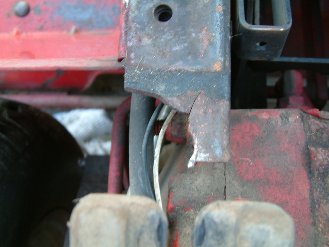

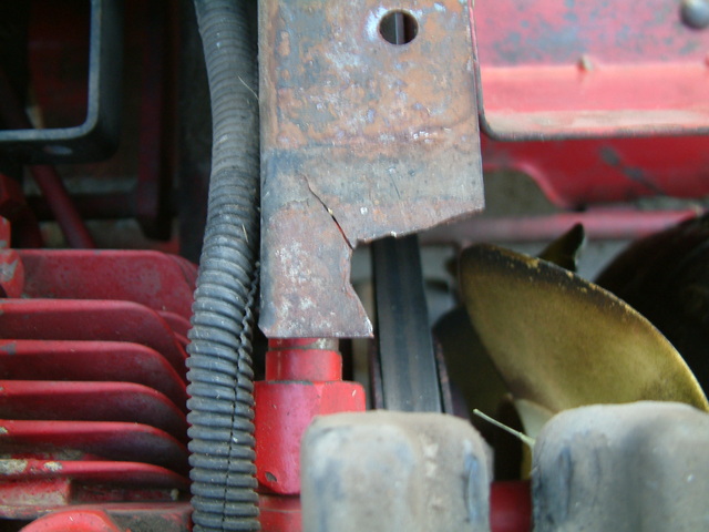

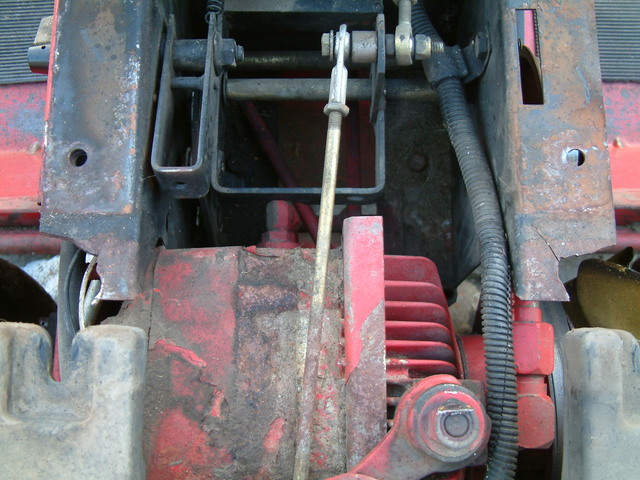

SgtBob 27 #1 Posted July 25, 2015 Looking for some help. I just bought a 416H and the rear tabs on the hood stand are broke off. The fender bracket has nothing to attach to. Is there an easy and secure fix or do I need to replace the hood stand. If it need to be replaced is there anyone out there with a spare hood stand ? Share this post Link to post Share on other sites

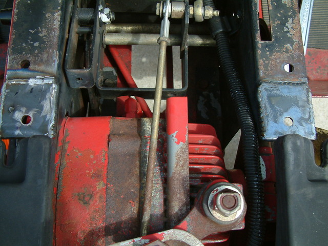

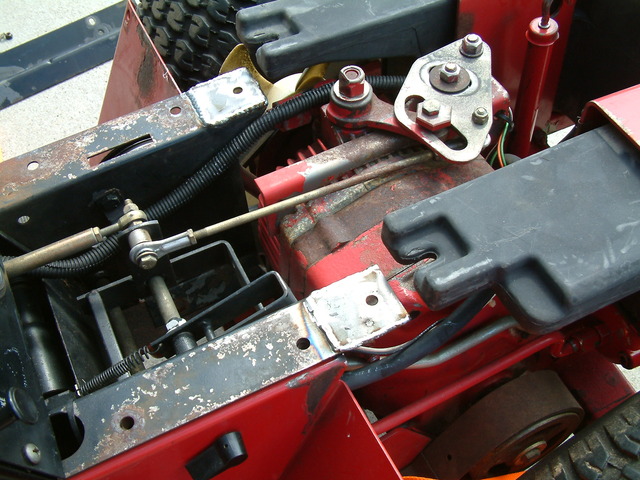

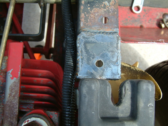

SgtBob 27 #9 Posted August 5, 2015 Well I took the tractor to a local welding shop and without have to disassemble any further & $25 this is what I got. Money well spent, much stronger than original !!! 1 Share this post Link to post Share on other sites
