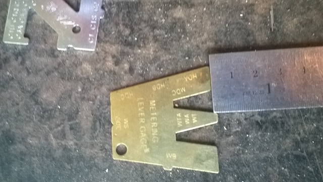

sorekiwi 761 #3 Posted July 25, 2015 Dont know if this will help you, the most common carbs use this setting, it is a hair over 1/16th inch. Share this post Link to post Share on other sites
