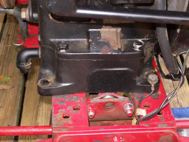

Kelsey 91 #1 Posted July 23, 2015 These past few days I've been doing some PM workon my son's WH 310-8. I noticed that there are onlytwo motor hold down bolts attaching it to directly to theframe on the side by the flywheel. On the other side,the pan hangs off the frame. Is this right? Share this post Link to post Share on other sites
oldredrider 2,553 #2 Posted July 23, 2015 The right side bolts go up from the bottom thru the frame into the pan. Share this post Link to post Share on other sites
Kelsey 91 #3 Posted July 23, 2015 Thanks Oldredrider, I went outside and looked underneath the 310 andsure enough the bolts were there. Shamefully, I used a hand mirror tolook under the tractor. Share this post Link to post Share on other sites
